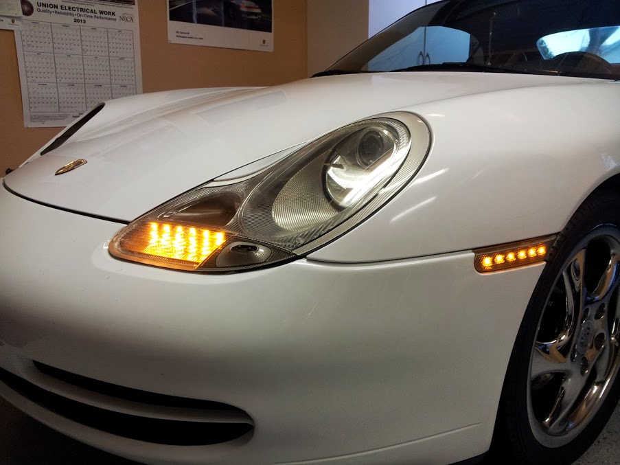

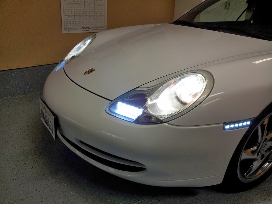

Here is my 2 cents
ID:	335073   Click image for larger version

Side Markers
Originally Posted by jayi836
Here is my 2 cents
Jay:
What can you tell me about those great looking side markers, which appear to be LED? I'd love to install a set if I can find a source.
Thanks,
Curt

Curt,
here is link to the post from last year.
Jay
https://www.6speedonline.com/forums/...ml#post3930846
