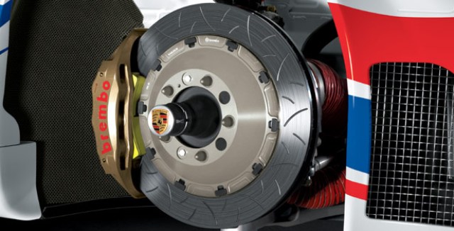

One thing to note is that I see Brembos mounted to the 911 GT3 RSR. What’s up with that?????
PCCB's are the best braks I have ever experienced.
