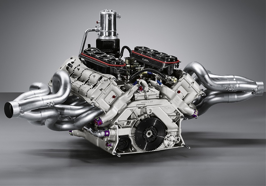

I run the 0W40 in the 997tt. My other Porsches get 15W50. I figure the bearing loads and piston speeds on the 8000+ rpm Gt3's do just fine on the 0W40 and should be just fine on the 997tt as well. I don't think Porsche would recommend substandard oils in cars that they have to warranty
I was reading last night, they use off the shelf 0W40 in the new DI RS Spyder motor.

Alcyon's Avatar
Joined: Dec 2006
Posts: 144
From: Spain
Alcyon has a spectacular aura aboutAlcyon has a spectacular aura about
Impresive engine! If that it is true there is no need of that higher grade on my engine ,I will stay with the same oil (5-40). Thanks
