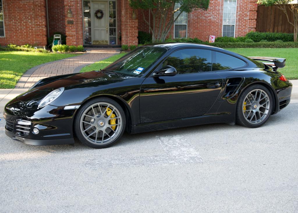

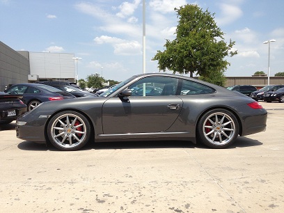

Update,
I now have the Bilstein Damptronics and H&R sways installed. It was completed today so I don't have a lot time driving it and I think there will be some settling however my first impressions are very good.
No question the ride is more stiff and a little bouncy on some bumps but that is to be expected. The positive is that I can live with it and I was actually expecting worse.
I can also state emphatically that the turn in and cornering feel much more stable and what little bit of sway there was in a turn seems to be non-existent now.
One of the best benefits I can easily tell is the lower stance than before. I immediately do a double take when looking at the car because what used to be a great looking car is now ever greater. It has a more aggressive bad *** look to me.
I'll have more and some pictures a little later. In the mean time, again, many thanks to Cannga for all the great information within this thread as well as the little nudge I needed to get this ball rolling.

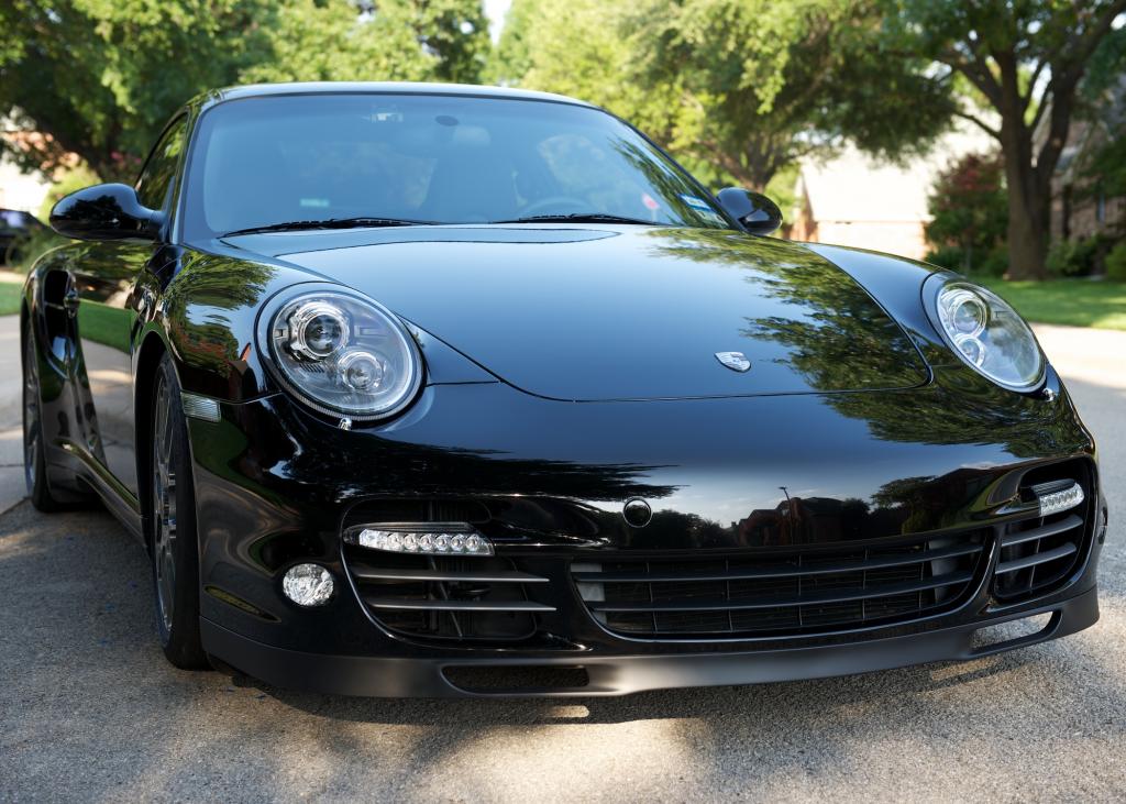

Nikon D800 and Nikkor 24-70 2.8

Hi Earl, you are very welcome, congrats and drive safely. Regarding lowering, I know, once anyone has seen their car lowered (if driveway permits), it would be extremely hard to go back to stock height. The effect is even more dramatic when you park the 2 cars next to each other: the non-lowered car will positively has an SUV look to it.
For anyone interested: I don't care how Bilstein does and how many they sell, but for the love of motorsports, if you are looking for tighter and more precise handling, I cannot emphasize a switch to the Damptronic enough. The transformation is unmistakable and IMHO will be the single most important thing you do for the Turbo (yes more important for me than exhaust and ECU tune - Porsche is about handling first and foremost to me).
Here also is one of the very few examples of something we do that benefits both cosmetically and dynamically. Lowering car also reduces weight transfer, a major benefit for high speed cornering, real science and no snake-oil :-). Lowering btw is the only thing we have within our power to reduce weight transfer. The other 2 parameters, car weight, and track width, are beyond our control (now you know why race car is wide, low, and light - it's about reduction of weight transfer).
Very nice pics and camera/lens - thanks for sharing. I am actually fairly off-the-chart crazy about photography - worst example of pixel peeper you'll run across. I have Canon system but recently has been playing around with Nikon cameras and the Nikon 14-24 f/2.8 zoom: very nice, but big and bulky, and still just one notch below Contax Distagon 21 f/2.8 for those nutty enough.

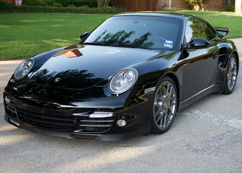

As some have noticed I swapped out the aero-kit front lip for the turbo lip as a temporary "curb-feeler" to see what issues I will have driving the local area as well as getting in and out of my driveway. The Turbo front lip is about 1/4 the price of the painted aero-kit lip.
One level surface the aero-kit lip was 6 inches above the ground before the Damptronics install. The turbo lip is 5.5 inches above the ground measured now. I think the aero-kit lip would be about 5-5.25 inches above the ground however it also comes forward over an inch so when the nose is down that becomes critical.

Very prudent using the cheaper front lip as a trial horse. Even at the higher standard clearance, in the hilly town I live I have a lot of effort to avoid scraping mine (I'm on my second lip; the first didn't last long).

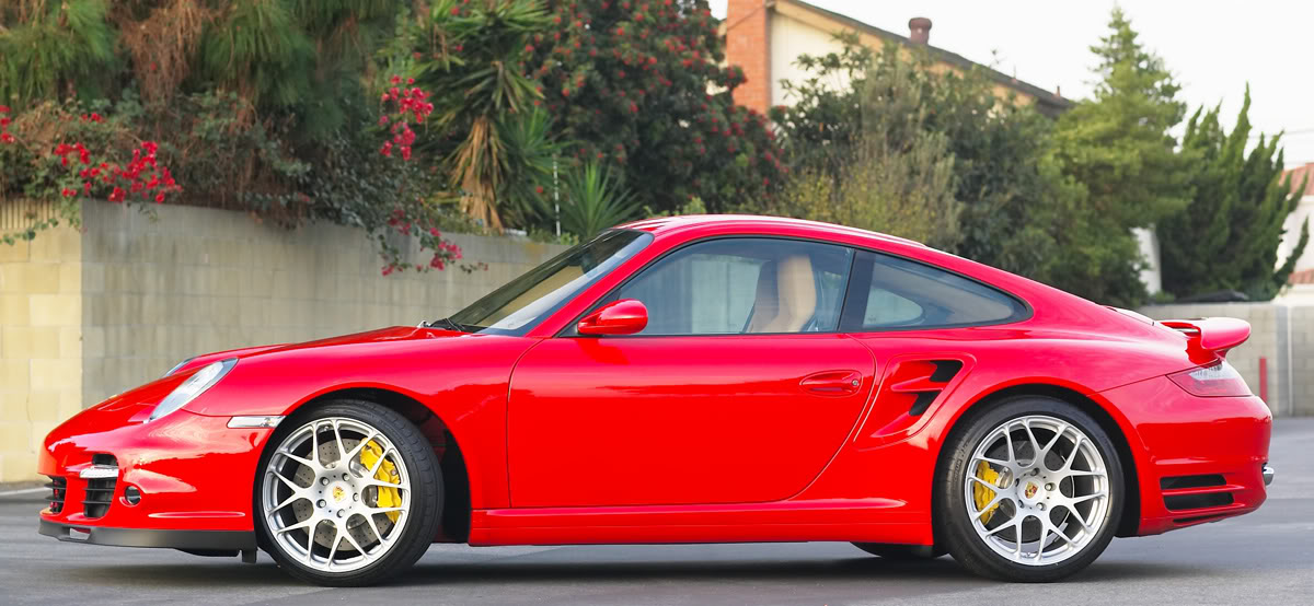

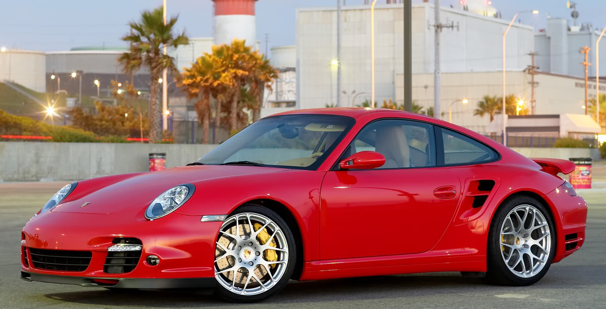

Before:
After:
[/QUOTE]
Can,
Beautiful car... Never really thought I was a big red fan but it looks great on yours...
Congrats and thanks for sharing the great photos. This coming from another photo nut.
Jim
