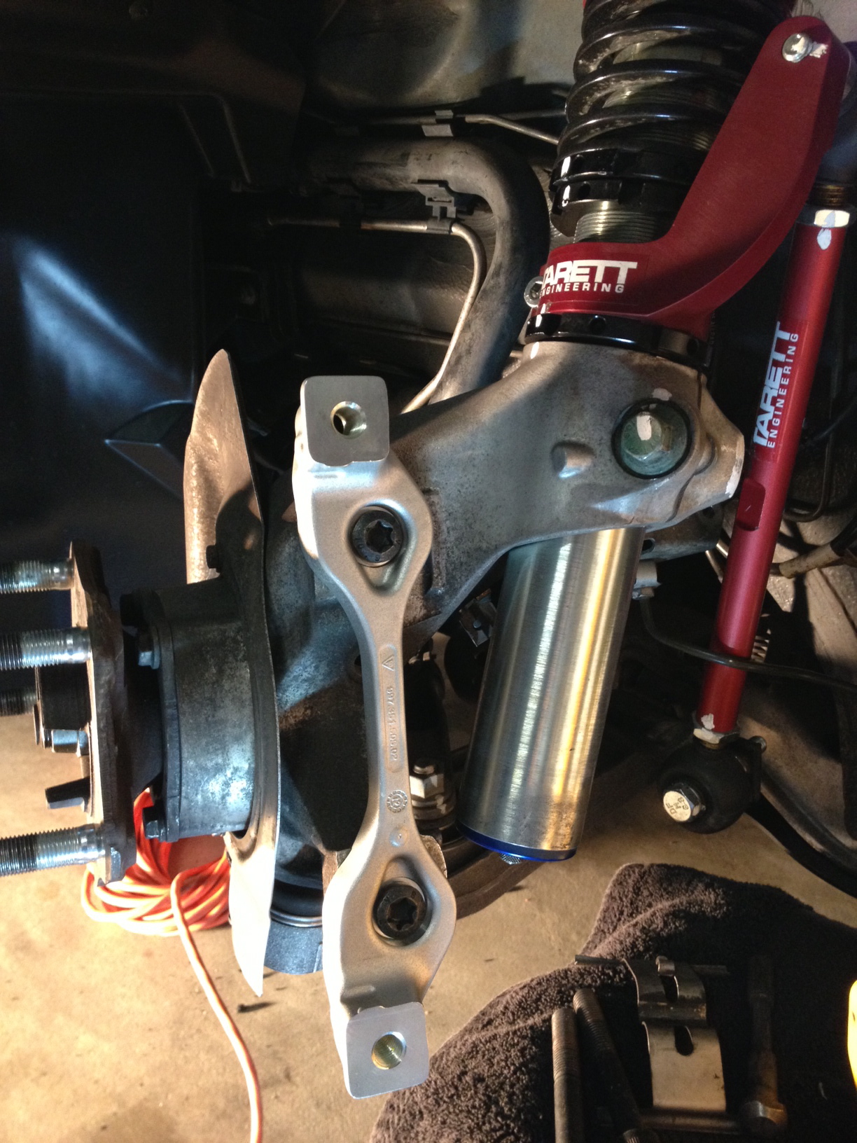

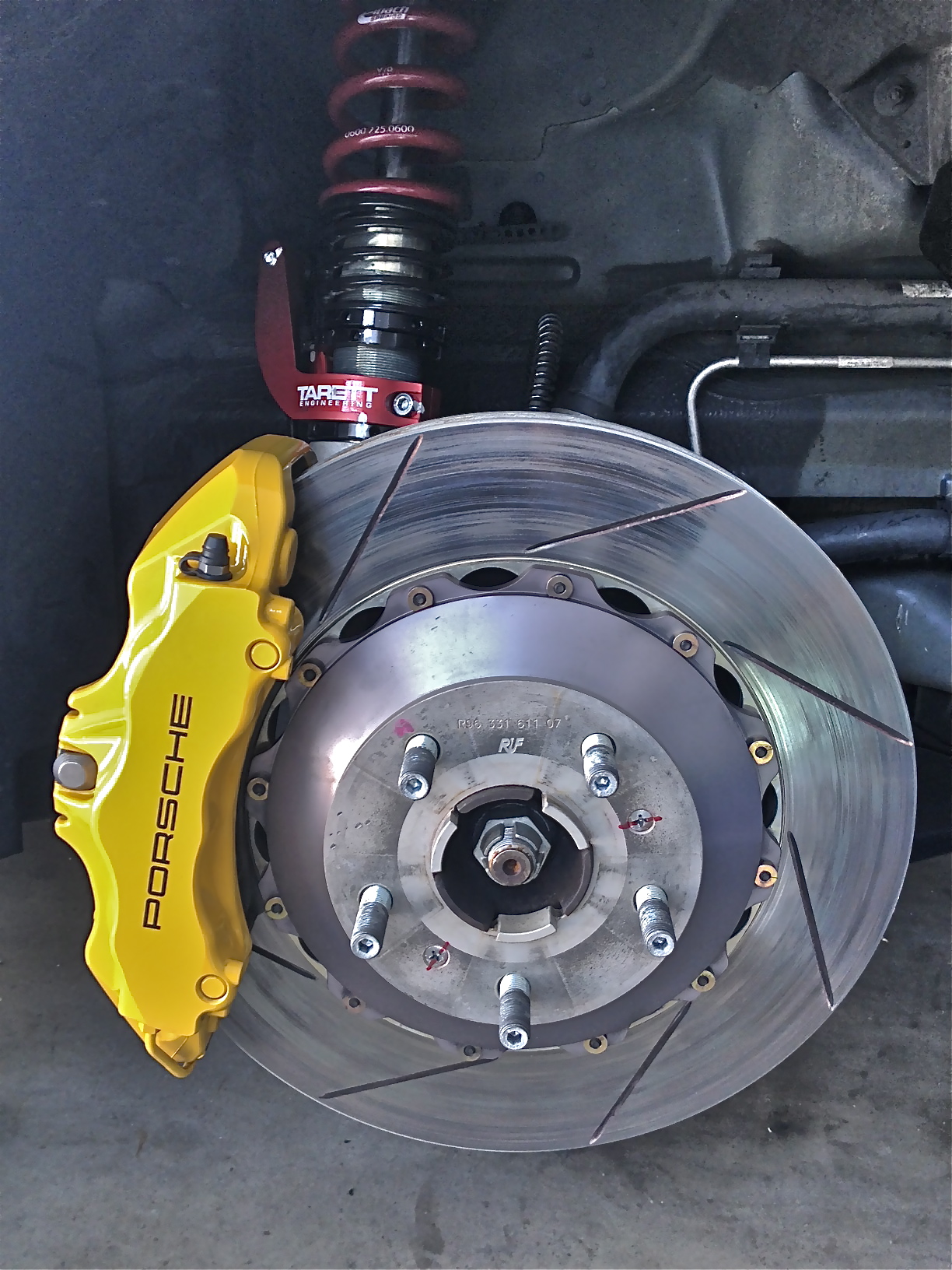

There you go Mario....
Name:	997.2 PCCB 380mm brakes.jpg
ID:	272527   Click image for larger version
Name:	Caliper bracket.jpg

Alright so here's the stuff I notice from your pictures and mine;
I need to put the black ring under the Drop Link arm.
I notice your Drop link arm is in a different position than mine. You can see mine is holding the Drop Link from behind the shock, like you can't read the Tarret sticker, because it's facing the front part of the car. While yours is facing the Brakes.
I'm thinking that's because of different cars though, as far as I understand, the drop link needs to be completely straight from the arm to the sway bar.
I got one question for you though... Like I mentioned before, I had my Sway Bar hitting against the car at the bottom, so I had to raise the control arm in order for the Drop Link to pull up the sway bar.
My question is... The black ring UNDER the Tarret control arm, does that NEED to be against the upright? Like SITTING on it? Or It just needs to be UNDER the Tarret arm? Because I'm not sure if I make it sit on the upright and then lower the Tarret arm again it might make the sway bar come too low and hit again.
I could always put two of those black rings though.
Advice?

Originally Posted by Mario911TS
Thank you!
Advice?
The black ring needs to be seated against the upright. It acts as a load bearing element for the shock. Right now the black ring above your swaybar bracket serves no function whatsoever. If you need to raise the sway bar then shorten the drop link as much as possible by screwing both ends into the sway bar drop link, and also screw the sway bar bracket up on the shock body itself. You have room there. This will effectively raise your sway bar as I am assuming it is contacting your lower control arm. Hope that helps.
That's exactly the problem I was having. The Sway bar was hitting the Lower control arm.
Ok, so the Black ring needs to sit on the upright.
But that brings another question; I'll put the black ring ontop of the upright, but if I raise the sway bar bracket on the shock, it wont be sitting on the black ring.
Is that ok?
Pretty much, The ring MUST be sitting on the upright, but the sway bar bracket doesn't need to be sitting on the ring?
Is that ok?
Pretty much, The ring MUST be sitting on the upright, but the sway bar bracket doesn't need to be sitting on the ring.
That is all correct. The sway bar bracket is secured via the "pinch bolt" on the bracket itself and does not rely on the black ring.

Got it. So I can raise/lower the bracket as much as needed for it to not hit the control arm.
And I'll change the black ring and put it on the Upright.
Other than that, I think my installation looks correct. Your bracket seems to be in a different position than mine, your "Tarret" sign is facing the Brakes, while mine is facing the front of the car. But I think this is because of different cars? The Drop link needs to be completely straight, right?
Ideally the drop links should be 90 deg to the sway bar but just make sure it's close.

I'm going to install my tarret drop links to tonight. I assume I just make them the same length as the old ones and both the same length? How does making them a little longer or shorter affect handling? In case I want to adjust at the track this weekend.
