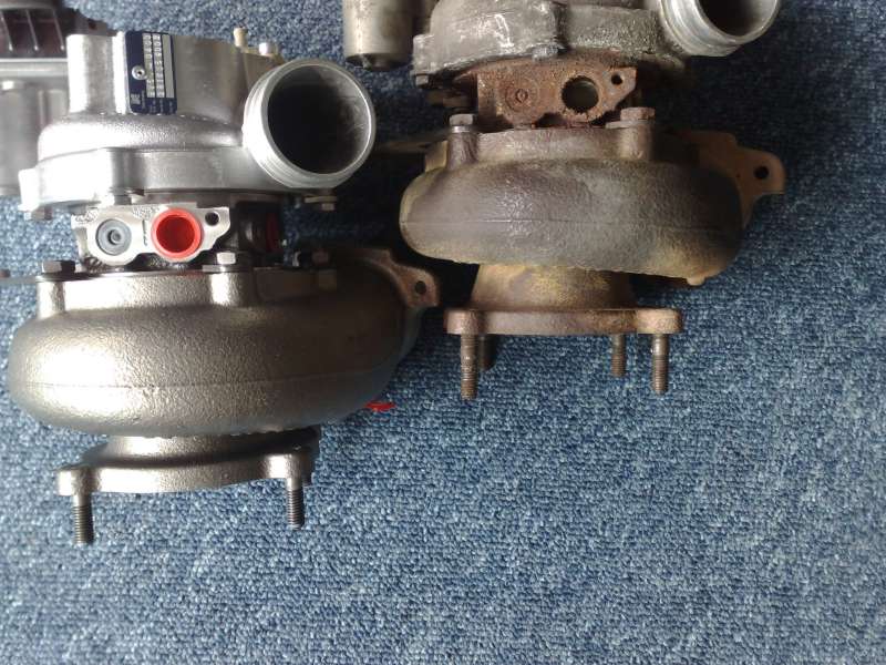

How can they be bigger ???

The AWE turbos have larger intake compressor wheels than the Gt2 units. RUS your picture shows a larger exhaust turbine housing on the left than the right. 2 different animals.

Yes...I know that...but mod GT2 turbos will produce even more power the mod TT turbos....

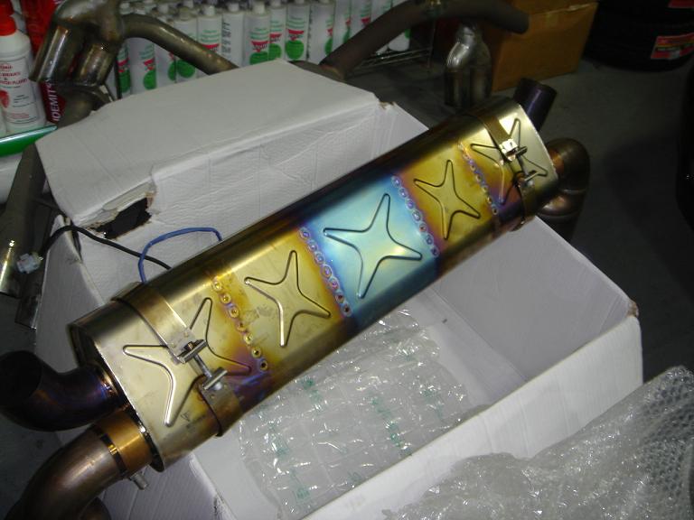

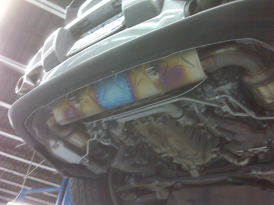

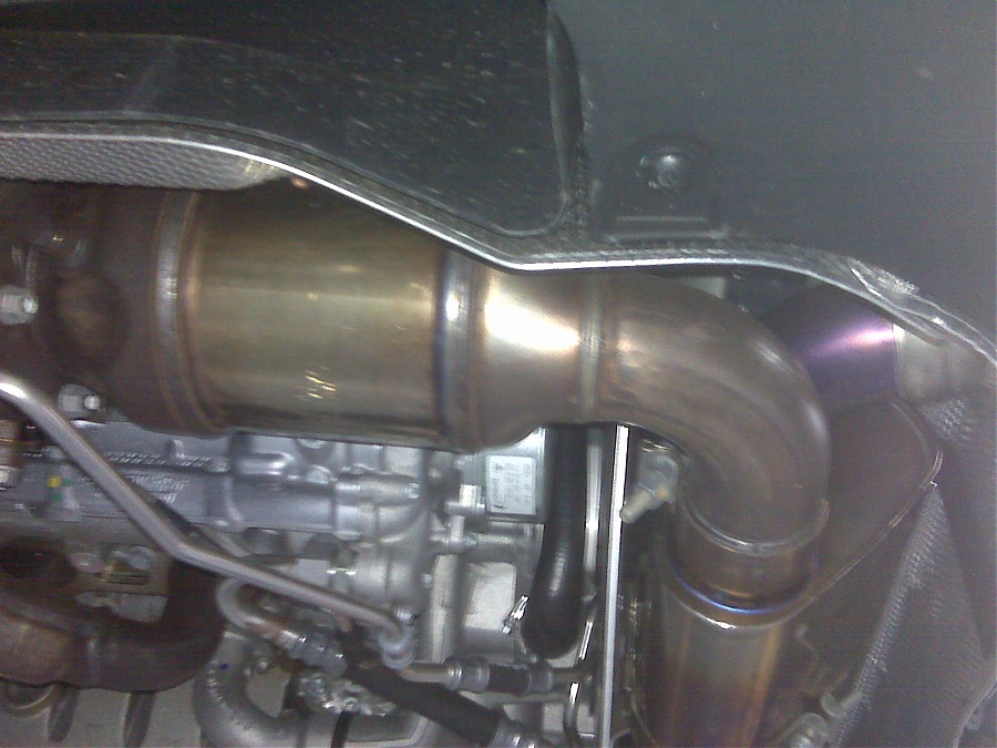

Check out this GT2 exhaust, very aftermarket looking, wonder who the subcontractor might be. Sorry crappy cell phone pics.
