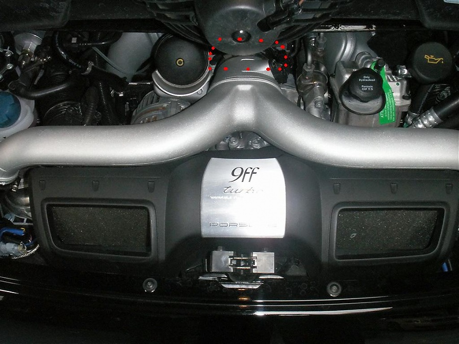

Ok good news!
I did a surprise walk-in later in the afternoon and managed to catch my favorite Porsche mechanic.
After explaining the symptoms he popped open the bonnet(?) and immediately found the problem.
The very large ORing-like part had slipped off, its the part connecting the pressure pipe (from the intercoolers) leading to the engine area.
Here is an image to better explain.
He loosed the metal clasp, fitted the o-ring part back on and tightened the clasp.
All is well, but ill definitely mention it in 2 weeks when I take it in for an oil change as im approaching 6,230 miles (10k km).
Still dissapointed that it came off.

Ohh my bad for possibly misleading you guys.
It was the only image on the net that correctly helped illustrate the issue.
