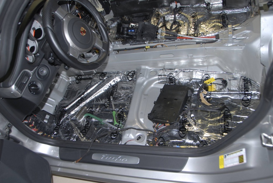

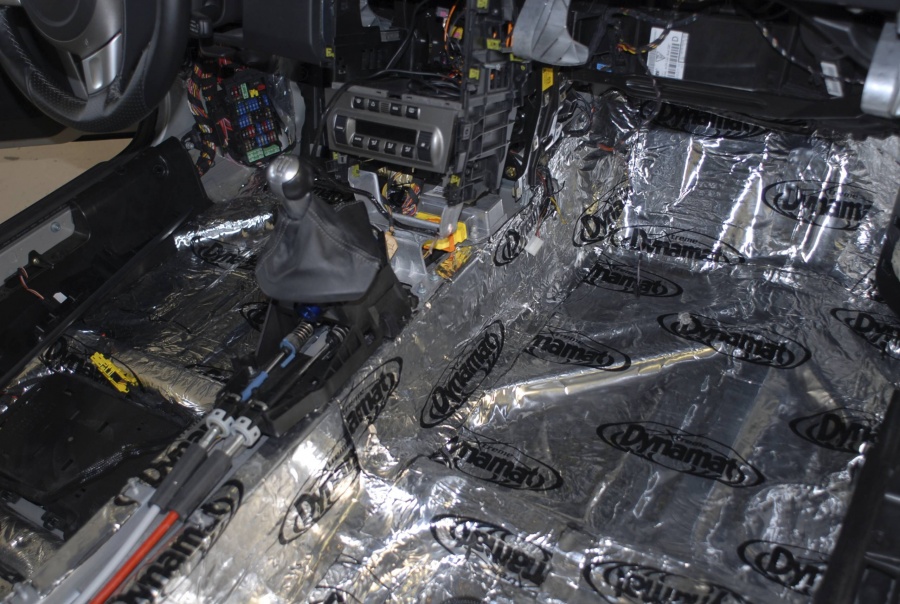

Here are some pics of the final Dynamat install (thanks to Arron of Marin Sound Works!) He installed the mObridge bluetooth system and a Passport 9500ci. I'll come back to post pics of the 9500ci install and wrapped springs when I get them. The 9500ci is great but I need my arrows so I'll put my V1 back in as well it think. They don't seem to affect each other's performance.
Check out the attention to detail with the Dynamat layout. Not pictured is the material laid just forward of the wheel well, where the gray felt is still attached. That was covered too. If it seems like I'm trying to plug these guys your right. They did a great job for me and Rob has done more for my car than I mentioned here at this time (valve issue, plugs, and a few other things not relevant to this post). Thanks Sharky! for "riding heard" on some of the other things that were done.

How long did it take to install all that dynamat?
It took about 40 hours to do the whole job which was to basically gut the car's interior, meticulously cut and fit the material, and then to reinstall the interior.
There are no buzzes or rattles. Aaron at Marin Sound Werks, San Rafael, CA. did the work and he can be reached at 415 747 8249 if you have any questions.

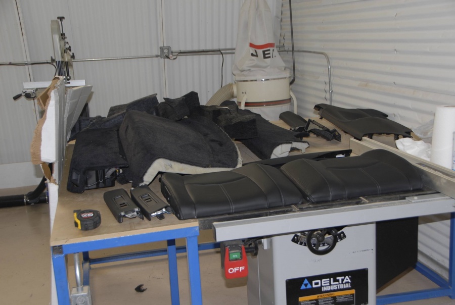

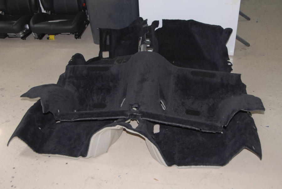

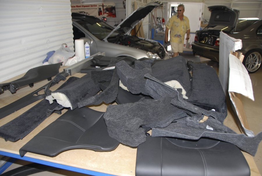

Here are some pics of the interior parts out of the car.
