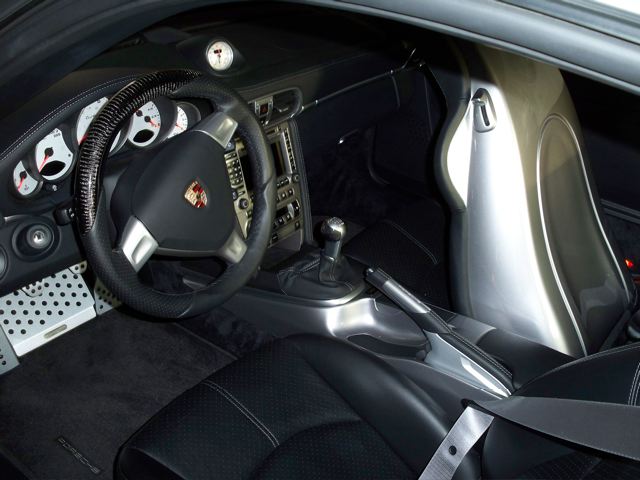

Old Dec 12, 2009 | 02:00 AM
twturbo's Avatar
Joined: Feb 2009
Posts: 1,331
From: Upland CA SoCal
Rep Power: 143
twturbo Is a GOD !twturbo Is a GOD !twturbo Is a GOD !twturbo Is a GOD !twturbo Is a GOD !twturbo Is a GOD !twturbo Is a GOD !twturbo Is a GOD !twturbo Is a GOD !twturbo Is a GOD !twturbo Is a GOD !
Originally Posted by bonehead
That time of year for Rennline's 15% off. I think I may need to get these. Thanks for the post on Rennteam, Can. Has anyone installed the metal floorboard as well?
I installed the whole Rennline pedal set including floorboards on drivers & passenger side ,it really seems to balance the look having them on both sides when your sitting in the car ,check out that TA wheel to my fav its sooo thick.
Damn you! I wasn't even considering the passenger side until you posted that pic.
