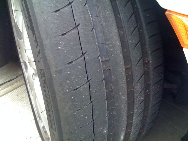

I've been to enough different places that I dont think its anything seriously mechanical, just annoying.
As for the tire wear, the majority of this was done in two days, so the outside edge was all that was worn as you can see, front and rears look equally bad:
Running with too much lower pressure...
