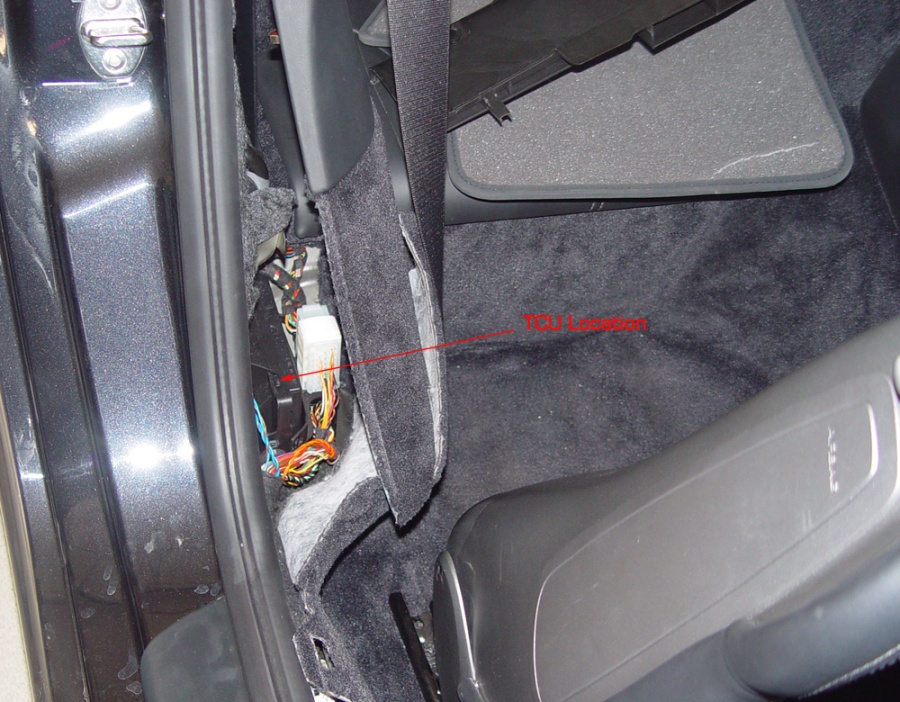

Originally Posted by Evolution MotorSports
No but a new TCU controller can be purchased and upgraded. The TCU from Porsche is about $500
I live in Russia and remove TCU and sent to you is a big problem for me. Can you buy new TCU and programm and after that sent to Russia?
