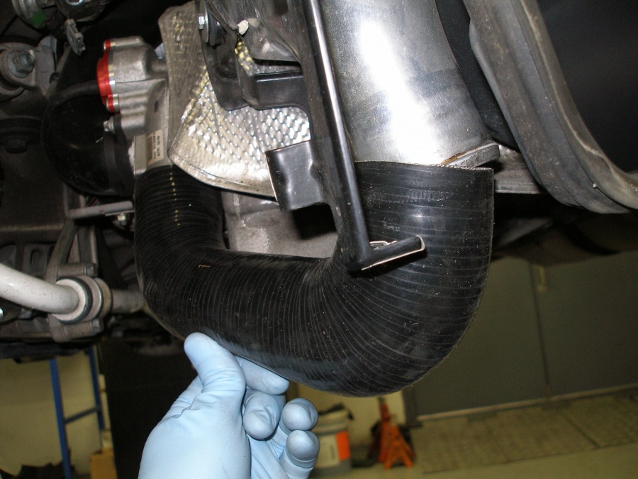

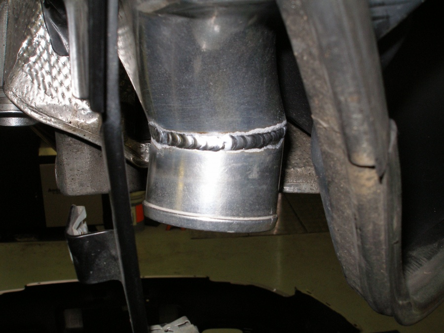

Ahh, the familiar swishing sound. I "have that t-shirt."
It is a likely a leak and it could be as easy as a loose hose or a blown hose or intercooler. I've experienced all three issues.
The first, easiest check is the short, single hose off the Y-pipe that connects to the plenum. Mine has popped off more than once. Make sure that it's securely clamped on at both ends. Mine has come off at the far side going into the plenum more than once.
If your using EVOMS cup intercoolers you may have the drivers side hose from that intercooler only partially connected. when my car was on the lift I noticed that and found that the hose didn't easily mate with the intercooler so it was almost off (see picture). I had the metal tube on that intercooler cut and re-welded in a more aligned position to accept the hose.
The fact that your getting some boost could mean that one of the intercooler hoses is blown or not seated well due to a loose clamp. Another possibility could be that an intercooler is leaking.
A pressure or smoke test can diagnose your boost loss but first check the hose at the Y-pipe as it is easy to slip on and re-clamp by the owner. When mine has come off all the way I've experienced no boost so I kind of doubt that it's the problem but it's so easy to check that you may as well do it. It may be that it's not all the way off.

Many thanks for the informative info and pics. I'm wondering if I should take it to the dealer or back to the shop that installed the exhaust? I'm leaning toward the shop but the dealer is just down the road and 15 mi closer. It would be an interesting warranty test but do I want to expose my mods to the dealer for this?
