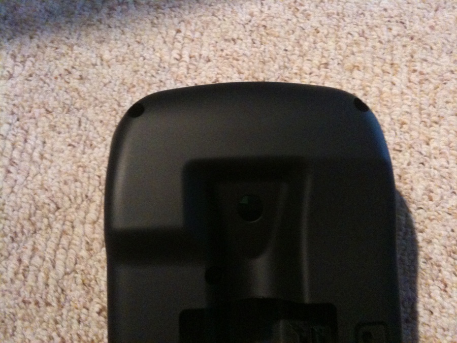

I can do better. I always find it easier to figure out how things are assembled if you can look at the parts ahead of time...here are some pics:
Picture 1 shows you the entire column together...they are not snapped together...they are hinged together. If you are sitting in front of the steering wheel, the hinge is closer to the dash...further away from the steering wheel.
Picture 2 shows you the hinge mechanism
Picture 3 shows you two torx screws on the bottom piece. They are located closer to the steering wheel.

If you unbolt the two torx screws closer to the steering wheel on the bottom piece, the part should open like a clam shell. You may have to wiggle the tabs off the leather/rubber piece that connects the top cover to the dash.
