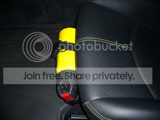

so my experience with suncoasts retrofit factory kit:
sucky!!!!
great once installled
the suncoast guys knew nothing about the installation, especially the difficulty of the installation
the factory brackets that you purchase have no threads or nuts on them, and there is no hardware included to judge how everything gets attached
the seat has to be removed in its highest position, then you have to work between the foam and baseplate to push the brackets between the seat cushion foam and the base, mind you that is after you "tapped" the holes to accept a 6mm bolt
this was not an easy process
once done it looks great, but 2 1/2 hours of labor (at 120/hr) was not the do-it-yourself that they described to me

The seat has to come off???? I think I will be putting my retrofit on hold for now...

not only does it need to come out of the car, but you need a special torx nut to get the bolt out
also must have the key out at all times or the airbag light will come on and need to be reset

I put mine in and it took about 5 hours. I would have haply payed 300 bucks to have it done! Seat comes out, must peal the cushion back, drill holes on the bracket and go to the hardware store for hardware. Looks good.

agree, looks great when done, but what a PIA

there is a 5 minute solution BTW which I put in my car. Not quite as sexy as the Safecraft or stock but you can use a generic Halon bottle:
http://speedtactics.com/porsche_extinguisher.php

it is a nice alternative...2 points:
1. to remove the seat bolts you need a special torx nut socket...snap op!...not available at sears or home depot
2. unlike the stock setup, this will not move with the seat which for some taller drivers may be a problem
