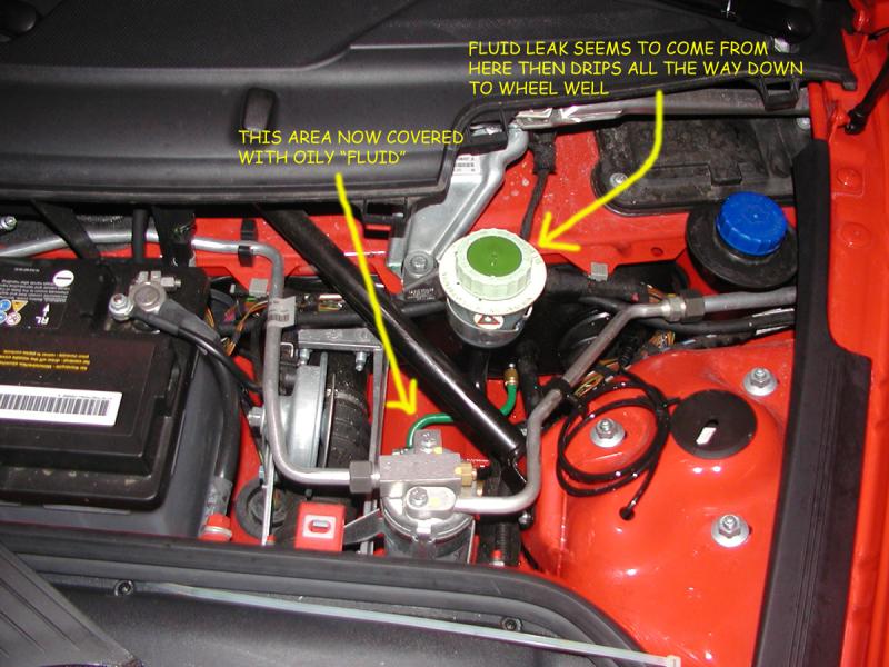

Alcyon's Avatar
Joined: Dec 2006
Posts: 144
From: Spain
Alcyon has a spectacular aura aboutAlcyon has a spectacular aura about
check if there is some leack here. (picture by Cannga)
