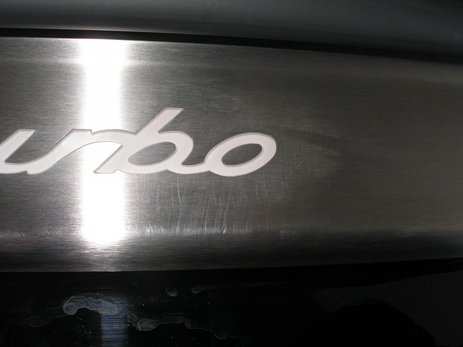

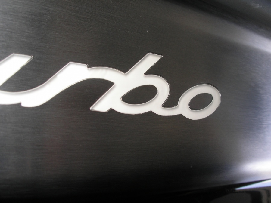

The side sills are uncoated stainless. There is no clear coat, it is brushed stainless not aluminum. You can do a very simple repair of scratches using the same technique that is employed for repairing stainless appliances. Deep scratches that you can feel with your fingernail can be repaired with proper sanding with the correct equipment. You can get your repair to match the oxidized portions of the steel with oxidizers. Here is my example, with a kit that I have used with very impressive results:
https://www.6speedonline.com/forums/...ches-gone.html
Before
After
