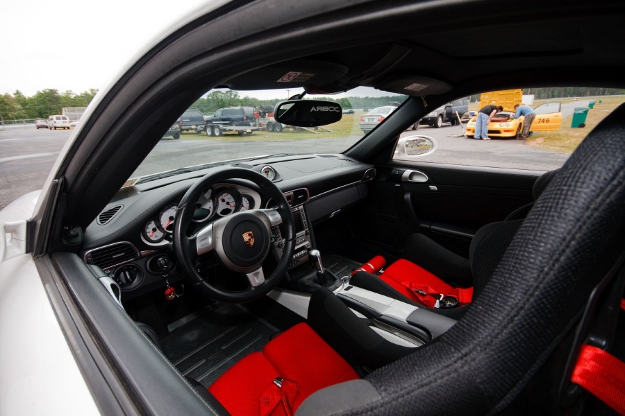

Not the best angle to see, I put in the GMG roll bar, schroth harnesses, and Cobra SuzukaS seats.
You cant use harnesses without replacing the stock adaptive seats unless you have the GT3 or GT2 seats.
I got the SuzukaS because they provide a lot more thigh support than either one of those two seats and it really helped to keep my legs in place through the turns.
Harnesses make a huge difference when braking, best upgrade to really feel the car and also improve your driving.
I'm taking out the roll-bar in two weeks and I'll be selling the seats as I'm going to be running the Exige on the track next year, if you are interested in either let me know.
Not the best angle, but didnt have any other interior photos.
