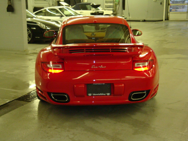

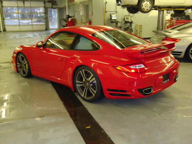

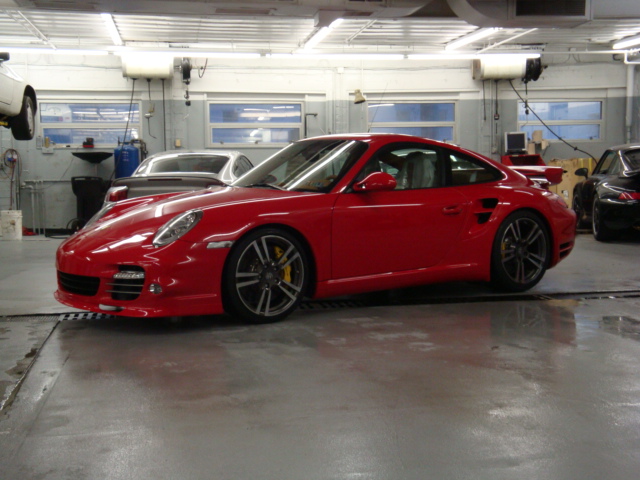

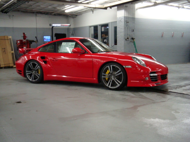

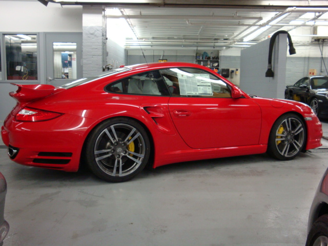

Thought I would share a few pics of a 2010 997.2TT Lowered. The cars just do not look as good as they should until they are lowered. Looks much better than stock! Lowering springs for 07-09 997tt work on 2010. Aftermarket front sway bars for 07-09 tt work but the Aftermarket rear sway bar does not. The new rear subframe brace is different for the new motor and Gen 1 sway bars do not clear the subframe brace.

Looks great. Techart ? Did you perform alignment yet? How is the ride now?

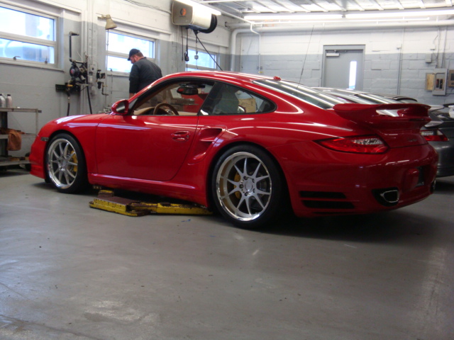

Champion Motorsports H&R spring set. H&R 26mm front sway bar. Still have to figure out what to do on the back.

It looks like the rear is sagging to me.

It is! I forgot to mention that the Gas tank is bone dry! We are getting hit with snow so I could not fill the tank half way then do alignment. Good eyes. I ment to mention it in the original post.

Installed Champion RS98 wheels. Car still does not have any gas in fuel tank so the front end is still a little higher than it should be. This NE winter snow storm has prevented me from taking the car to a gas station to fill up tank.
