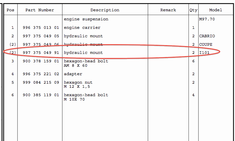

I am taking a different approach as i dont track my car much , mostly spirited driving. Instead of going with wevo or rs mounts , I was thinking of using gt2 oem mounts on my 997.1 tt. i checked from renntech / loren that it is a motorsports part # and all the hardware for both cars is the same. theoratically it should fit but not sure. can somebody with a 997 gt2 take a pic of the engine bay with the mounts. i want to see what they look like. much appreciated

bro they're exactly same ! there's no different between the engine mounts except the turbo's as i know .. !
if m wrong pls correct me !
I101 is PET code for the GT2:

Thet are differnent part nums. Gt2 is motorsport num

Its not a motorsport nr its a regular nr, i would bother change to the gt2 engoen mounts no diffrence

Why do you say that smr, have you tried it out, its definatley a differnt part # and it ends with a 91 and I was told that's motorsport part. I am talking about a 997 gt2 part #

So i removed the turbo engine mounts and installed the gt2 engine mounts, they were exact fit and as i suspected the turbo mounts were soft i could move the shaft with my hand, and ont the gt2 mounts i could barely move the mount shaft. so it is confirmed that the gt2 mounts are motorsport part #. (stock look) so it is lot stiffer then turbo mounts. waiting to install the exhaust . will keep posted about the drive feel.
