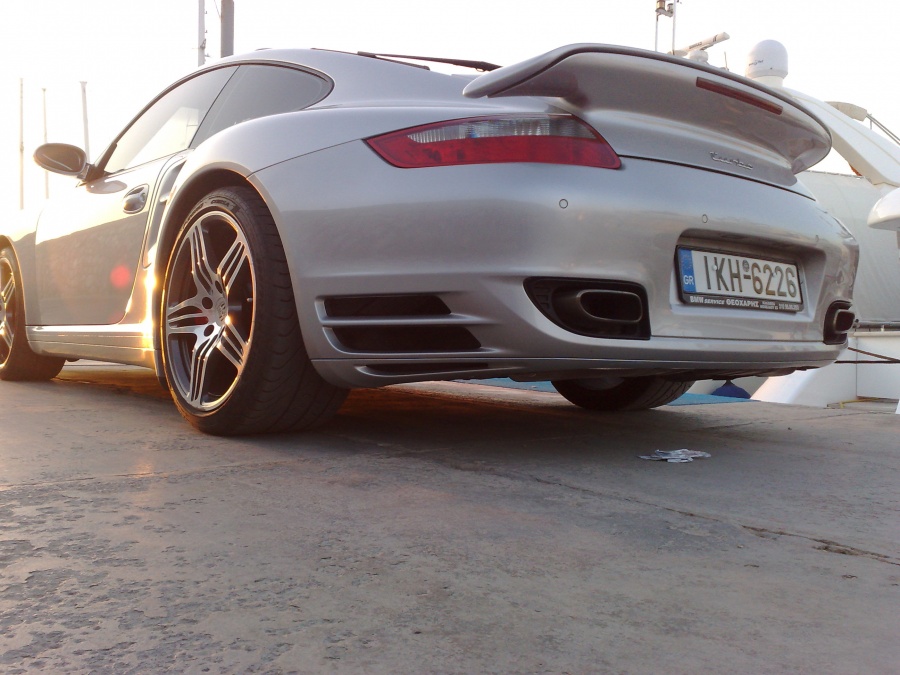

It was stock (well as I bought it) for about one week...Too much time for me...So I decided to color code front grills,front,side and rear skirts and also I did a DIY DRL...comments?

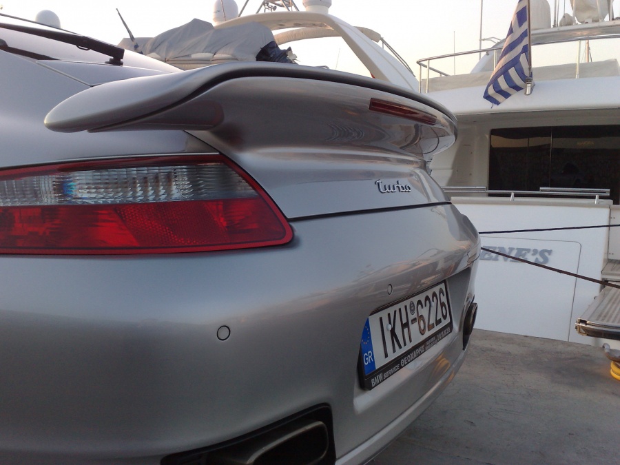

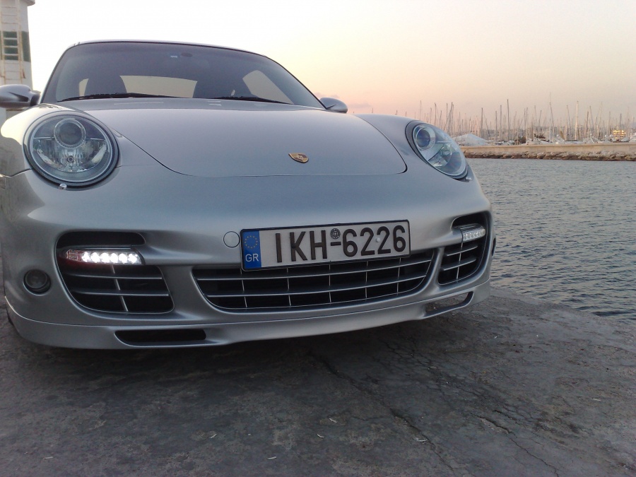

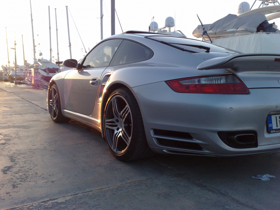

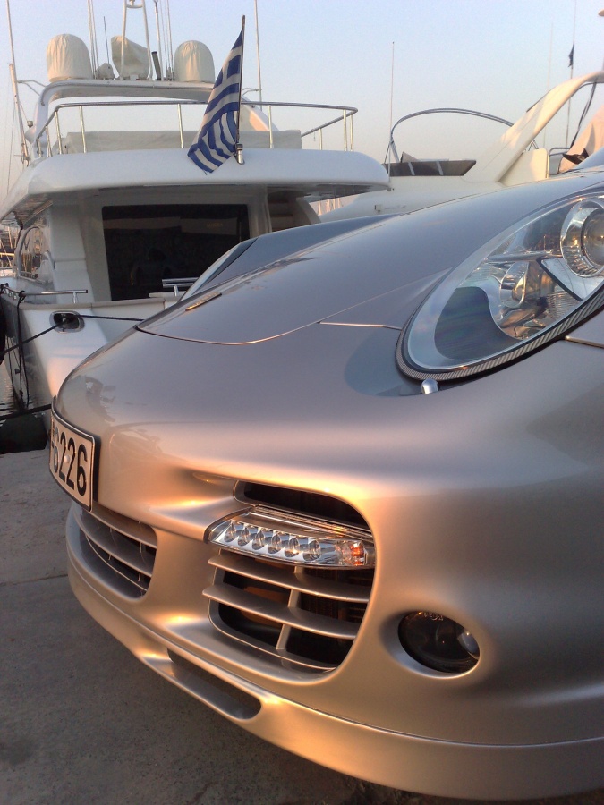

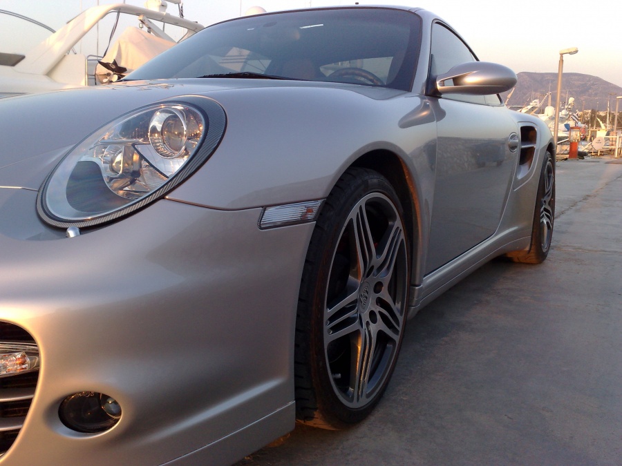

A few more pics...

DIY DRL?? Can you elaborate?

Yes...I removed front turn lights and heat them with a heat gun...By doing so I managed to open them and view their inside...i replaced yellow leds with high intensity white leds and glued the light again...Also standstill whilte bulbs were replaced with yellow ones...then I reversed cables from front turn lights to standstill lights,so when turn lights are on,+12Volt turns on 5W yellow buld and viceversa...Lastly i had to code the car with PIWIS so to "see" bulb lights and not LED lights for front turn lights...That was all...Now standstill lights are white LEDs while front turn lights are yellow bulbs located where white standstill bulbs were before the mod...
