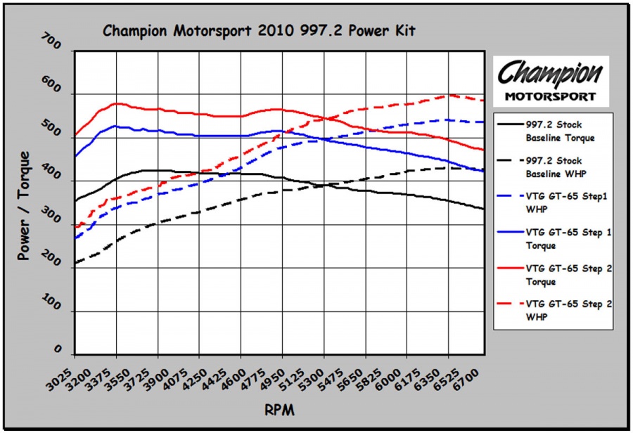

As you can see from the Graph that I posted, we made some very sizable gains in performance. Our baseline numbers on our 500 mile break in car came in at 431 peak WHP, and 425 ft-bs of torque. We are confused how
our numbers are so dramatically lower than other tuners have posted, as we all seem to be using Mustang 4 Wheel Chassis Dyno's, but we feel that these numbers are correct and inline with what Porsche publishes of the
standard car in regard to crankshaft measured power output. Basically, we do not feel that the car is over-rated from the manufacturer; it is just that great of a car..
In reference to the graph, what we plan to offer is a Step 1 Kit for PDK owners which will output 542 whp and 527 ft-lbs torque, and for Manual transmission car owners we will offer a Step 2 Kit producing 598 whp, and
579 ft-lbs of torque (clutch upgrade required and available). This is well into the 700hp range on pump fuel, without modifications to engine internals.
Our kits are always conservative, as this is our business plan. We believe that this kit will out perform our own posted numbers on most dyno's in this country and we will promote our customers to test their cars. I can
tell you from first hand experience that a 997.2 PDK with 540+ ( I have driven it at the full 598 carefully) WHP is an exhilarating ride. The traction control struggles to keep up, and all this in a car that will run a standing
1/4 mile in 11.0 seconds stock !!
We have a date scheduled for track testing, both on the drag strip in controlled conditions, and on the road course. We will have a v-box fitted for collecting real publishable data, and when we have collected it we will
post it for all to see. There will be journalists present to test the car with the highest international credentials, so you can be sure the results will be true.

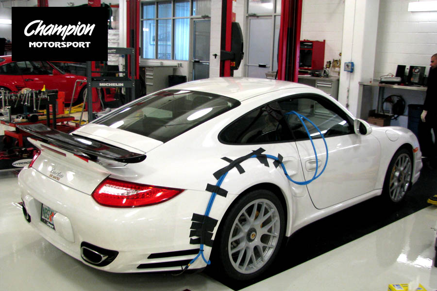

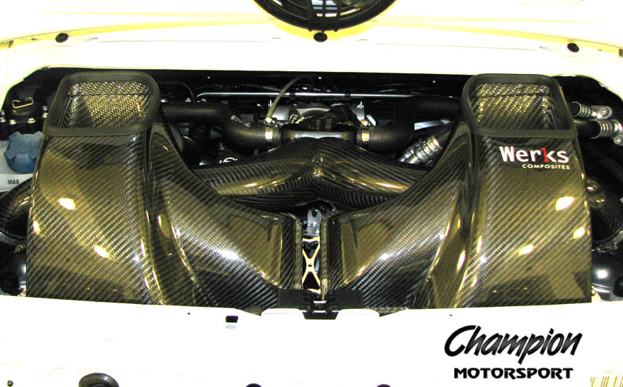

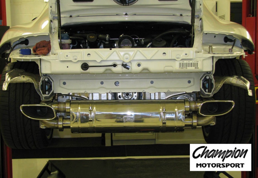

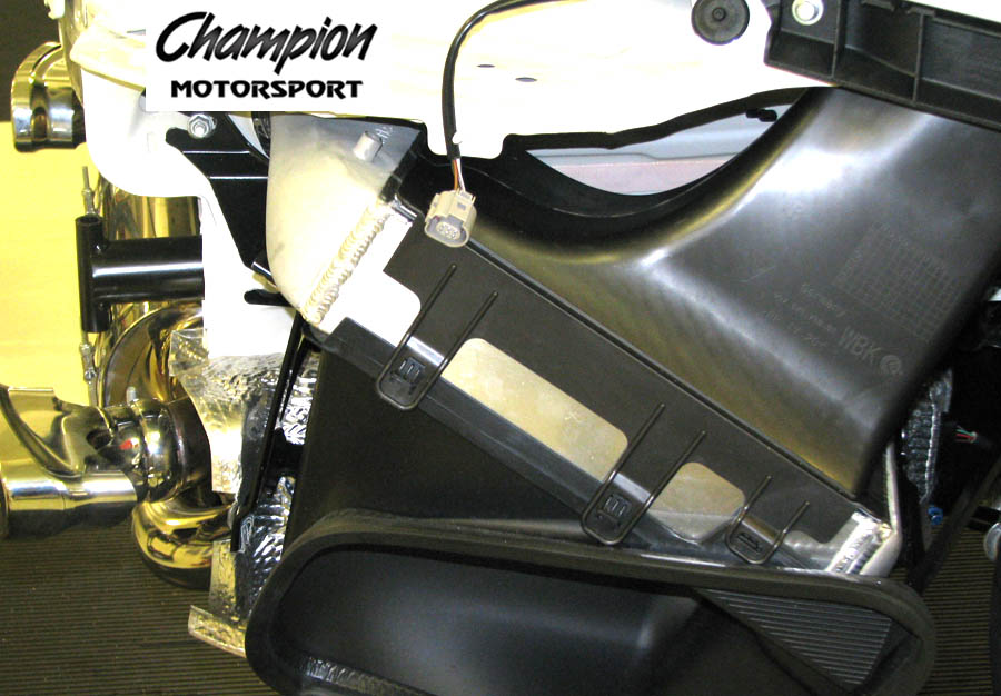

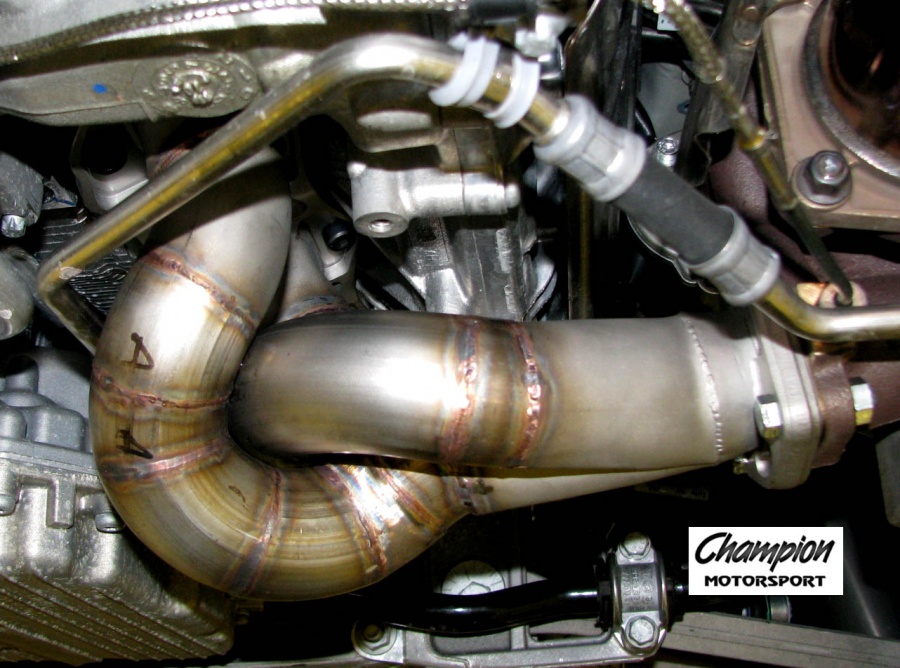

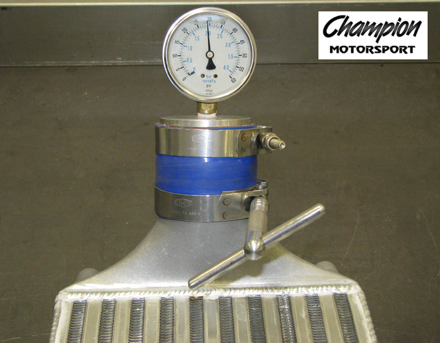

Below are some photos of some of the products during development, production parts will vary slightly physically (ie hand built manifolds) to control costs. There will be more to come, and we will keep this thread updated
with further developments. The basic kits are ready for sale, and we are taking orders now. In house installs can be scheduled immediately.

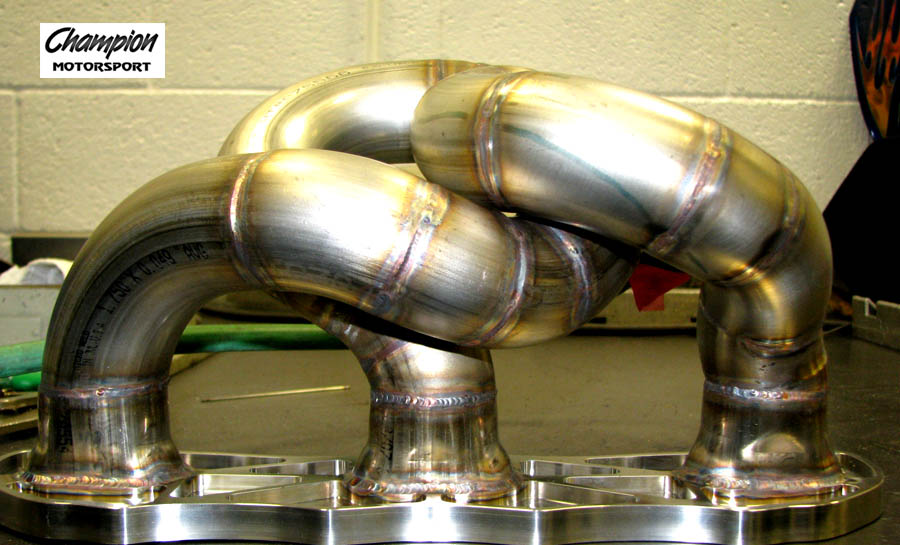

You guys have sure put some work in on that. Love those headers too..very fancy work.

I am not a fan of Carbon Fiber in the engine bay of our Cars, but WOW!! That airbox/intake is a work of Art... Nice going guys...

The ECU tune is done by GIAC? Specific to Champion Motorsport hardware in this powerkit?
Does "Step 1" kit mean ECU tune only, and "Step 2" means ECU and exhaust? I assume the GIAC tune for these lower level kits would be more universal?

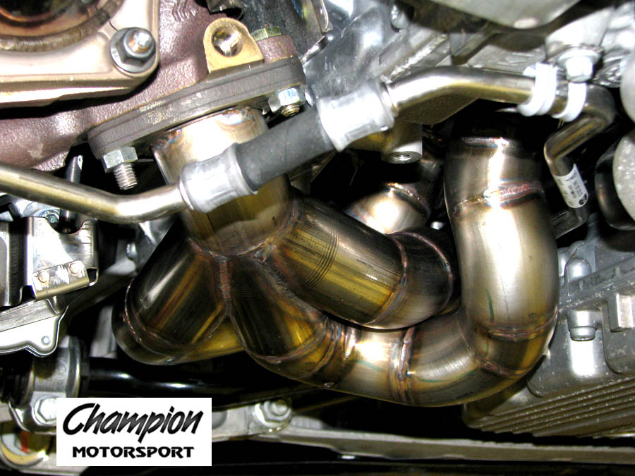

WOW! Parts look great Louis!
The manifolds look very sturdy! I like the webbing on the flanges for added strength!
Looking forward to seeing what hp will jump to when you upgrade the clutch discs! SSP seems to be making upgraded cluch discs for all cars with dual clutch transmissions.
