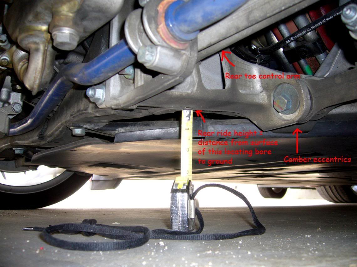

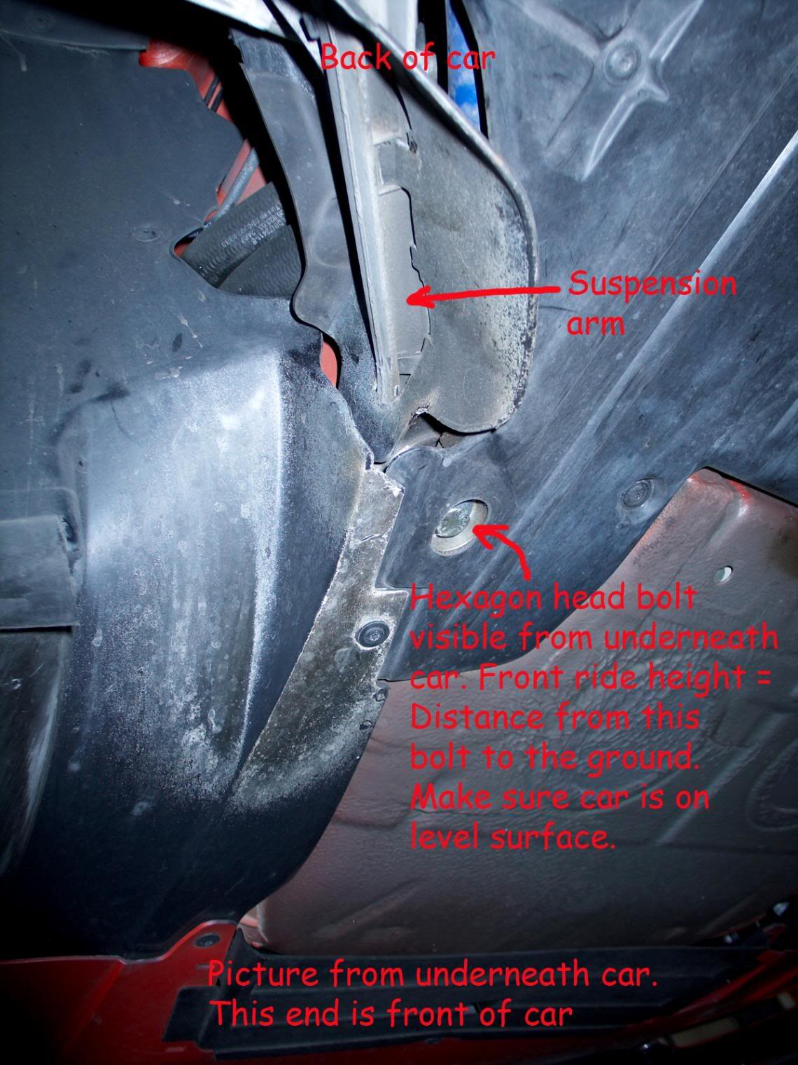

From cannga's Bilstein review:
Front:
Rear:

Neither technique is more accurate than the other, per se. The Porsche method is more reproducible, because all the measurements are taken at a standard point of reference. So, when JoeBlow in California measures his wife's car, he can compare it to Hans' in Germany, more importantly the various porsche service centers at dealers world wide can use the same nomenclature. However, as long as you are doing the measurements at a uniform position on the fender, or what have you, your measures are just as valid as the guy crawling under his wife's car. The same variables apply to both methods; namely tire pressure and ground condition. The fender method is the tire/wheel industry standard because it can be applied to multiple different cars, as Damon from TR mentioned. There is nothing magical about the Porsche engineers picking a certain chassis position to measure ride height, only magical thinking
Where am I going wrong?
You went wrong because part of your paragraph is correct (green) and part is not (red); part is logical, and part is "curious."
Have you tried to measure using the technique mentioned by Damon/Tirerack? There are multiple points of difficulty and potential inaccuracy with respect to marking fender and center of wheel -- please go back to my posts above and read it again carefully. In fact, if I were a customer of Tirerack, I would insist that the tech use the Porsche defined technique.
