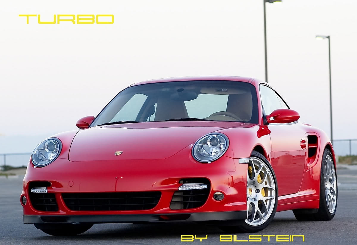

Pics & Review of My Bilstein PSS10 Lowered Red Turbo
Great! Although I absolutely love the Bilstein PSS10, I would never declare it the "best" because I know there are many other advanced and technologically superior systems out there, like your JRZ. I remain curious of other coilovers.
