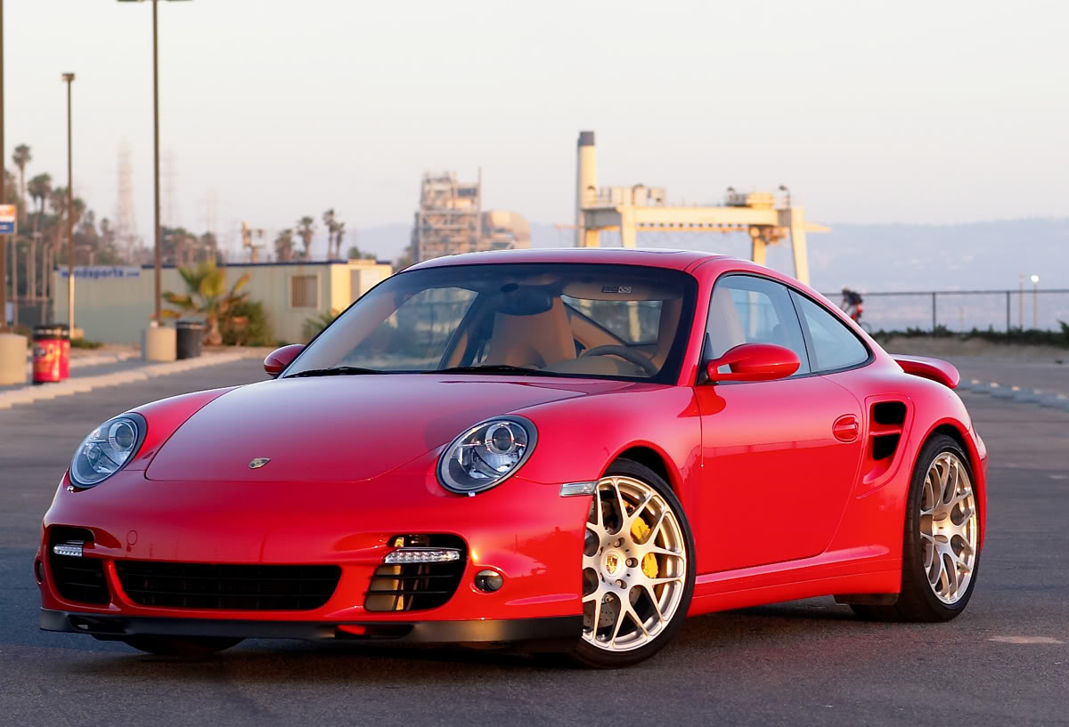

Before
After

Can,
This is by far the best analysis of suspension mods I've read anywhere for this car. And it precisely and comprehensively addressed the two options I was considering: progressive springs (GMG), versus PSS10s. Thank you for taking the time to relay your analysis, decision process, calibration and driving experience results. You really have helped me as well as many others to concretely conclude what we have suspected but were unable to confirm. THANK YOU!

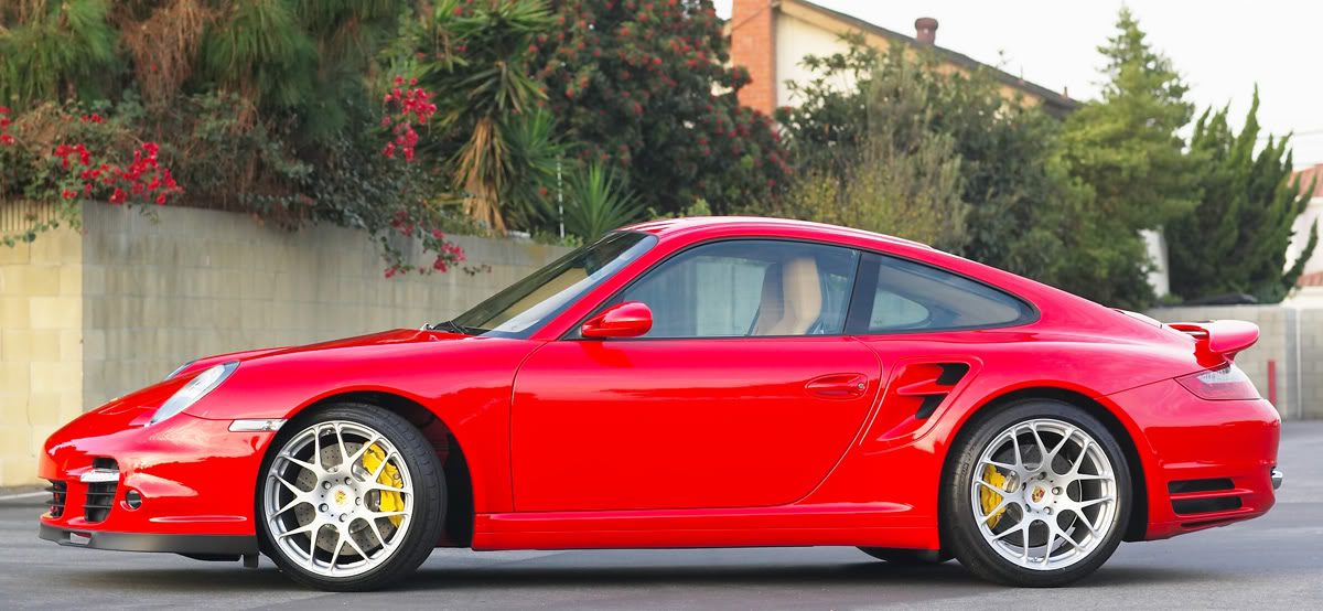

Thanks again. Do I have any side shots? Is the sky blue?
(I am a photography nut who takes my car to hours-long photoshoot.)
Kidding aside, I actually don't have many 100% profile shots, since the side view to my eyes is the least complimentary for the 911. Here are 2 that come close:
Before:
After:
(I am a photography nut who takes my car to hours-long photoshoot.)Kidding aside, I actually don't have many 100% profile shots, since the side view to my eyes is the least complimentary for the 911. Here are 2 that come close:
Before:
After:
