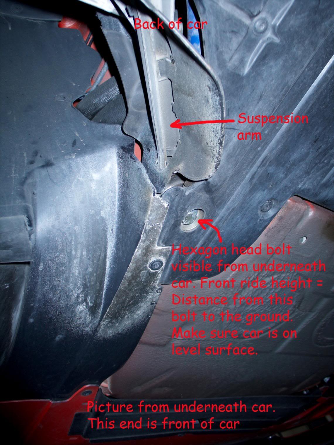

Front ride height is measured from this hexagon-shaped bolt, to the ground. The bolt is not visible, but could be felt through an opening in the plastic tray underneath the car.

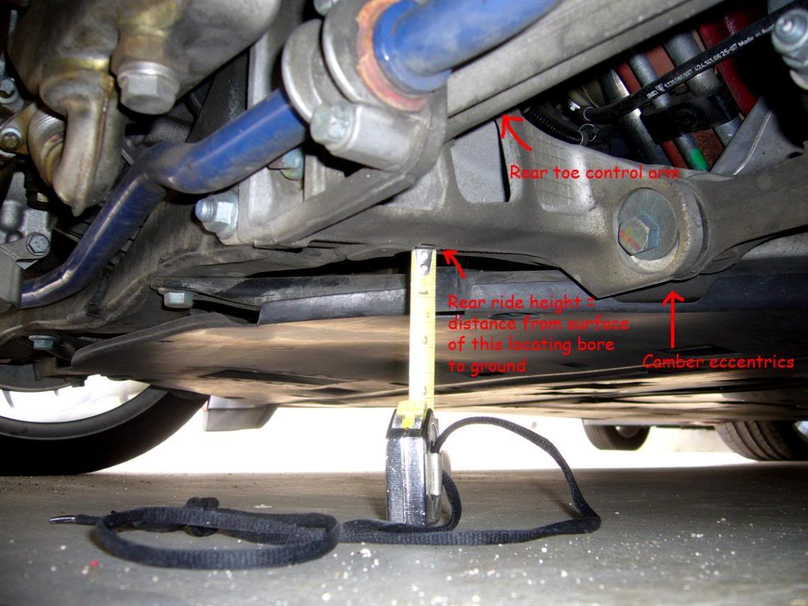

Rear ride height is from the locating bore, which is a round opening on the frame. That's it! Good luck and have fun measuring.
