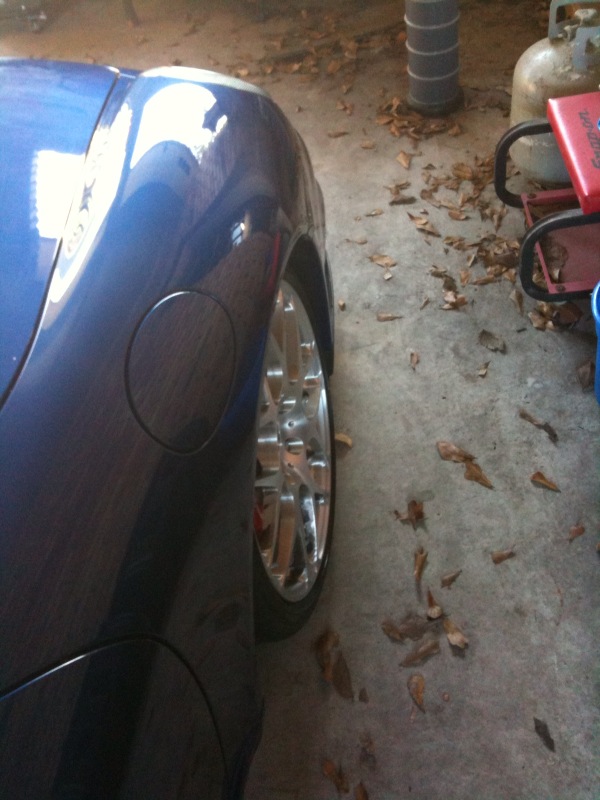

Help! Just backed my '09 Turbo out of the driveway, heard a loud "POP" and looked at my passenger side front tire to see the top of the wheel leaning in towards the car! The local Porsche dealership just installed the Bilsteins last month...I haven't driven 250 miles since they were installed (extremely light, city and highway miles)Name:  photo.jpg
Size:  120.4 KB. They have always had a little popping noise coming from the front (especially the one that is now screwed) but I just figured they were getting "broken in." Any help as to what you guys think happened would be GREATLY appreciated!!!

Open the hood and the plastic covers over the shock towers and make sure all the threads/bolts are where they should be (look at the other side). Make sure they haven't sheered etc... Take a picture etc...

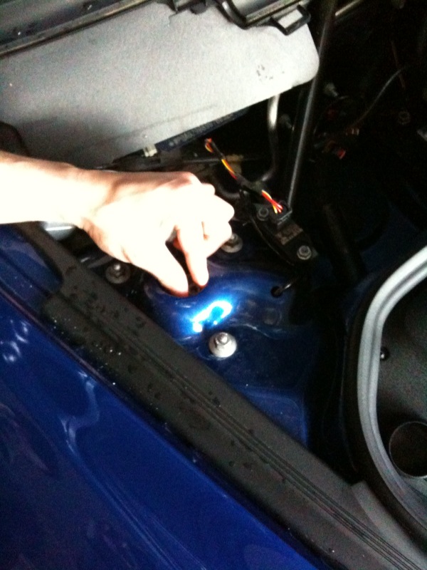

Took off the plastic pieces...the bolt on top of the shock was completely stripped (iPhone all of a sudden doesn't want have email work properly, so I can't post the pic)! Loose as a goose and it almost looks like the shock body is bent??? Porsche mechanic says he has never seen this in his life, and wants to come back to my house on Monday, pull the wheel, and get a detailed look at what is wrong before we approach the vendor who sold me the shocks (they're VERY popular on 6speed, so I'm sure they'll make it right). I'm now VERY nervous that all the other shocks might have problems...should I ask for 4 new shocks???

iPhone finally worked...here is the pic...the bolt was completely spinning inside of the shock!!!Name:  bolt.jpg

Yeah that doesn't sound/look good at all! For sure have a pro look at the area (uninstall etc..) before even moving the car anywhere. I'd get a replacement for sure. Haven't ever seen that either. It's good that you stopped right away though.

Figured it would be something like that after seeing the picture of your wheel cambered in like that. Make sure you have a qualified suspension guy look at everything and best of luck getting it fixed.

Yes, Porsche tech said we'll be taking several pics before we approach the vendor for a refund...we can look into the wheel well at the top of the shock and it almost looks like the damn thing is snapped in half on the inside? Very difficult to describe...never experienced anything like this in my life...never with any shock period...extremely weird! I'm just glad I wasn't driving down the interstate or something when this happened! Backing out of the driveway, turned the steering wheel to the left...then POP! Started driving down the street and turned around immediately because the steering was wobbly!!
