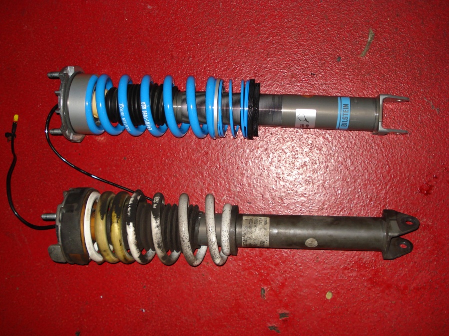

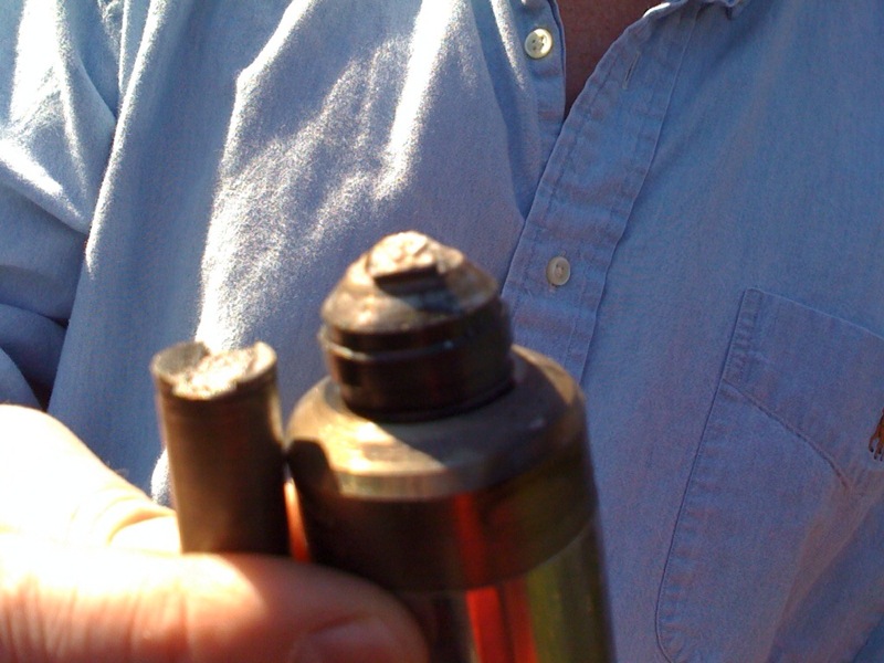

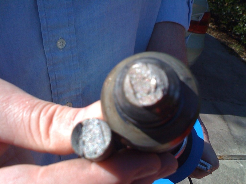

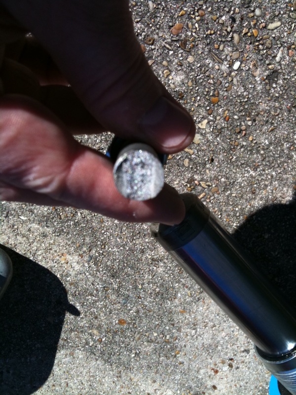

Update
OK, the Porsche tech came over this afternoon and removed the shock. Pics are attached. There is now, absolutely no doubt in my mind whatsoever, that this is faulty material. There is no twisting, or any indication of installation error in my opinion. I am not a metallurgist, but this looks to be the absolute cheapest steel I have ever seen! It looks like pumice on the inside! It simply snapped into two! It is definitely cast, and looks unbelievably brittle. A client of mine, who has a machine shop, says there's no doubt it's faulty material in his mind as well. Granted, he's not a metallurgist either, but works with steel, aluminum, etc. on a daily basis. After I receive my new shock, I'm going to put them back on and if there's a LICK of trouble will go back to stock and just live with the "hoppy" *** the car has in stock form. Anyone please feel free to chime in on your opinion of the pics.

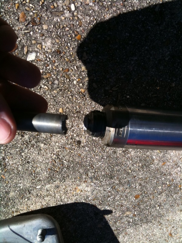

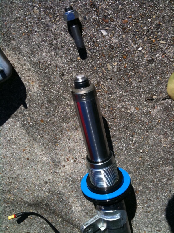

Update 2
Couple more pics.

the metal failed at the corner of the step up on the shaft. There should be a generous radius there machined into the material to minimize a stress riser. The metal at the failure point doesn't look any different than regular steel
Don't have a clue what you just said, but sounds like you know more about this stuff than me!

I would not be surprised at all if these were knock-offs, I would get the mfg involved and see if they are legit. There are a ton of knock-offs out there that are very hard to tell from the original these days (packaging as well) including Bosch fuel pumps.
Not to say your vendor would intentionally do this, however they do get into the supply chain.
Mike

I wouldn't be surprised if the steel was imported from China. Bilstein is the cheaper alternative.

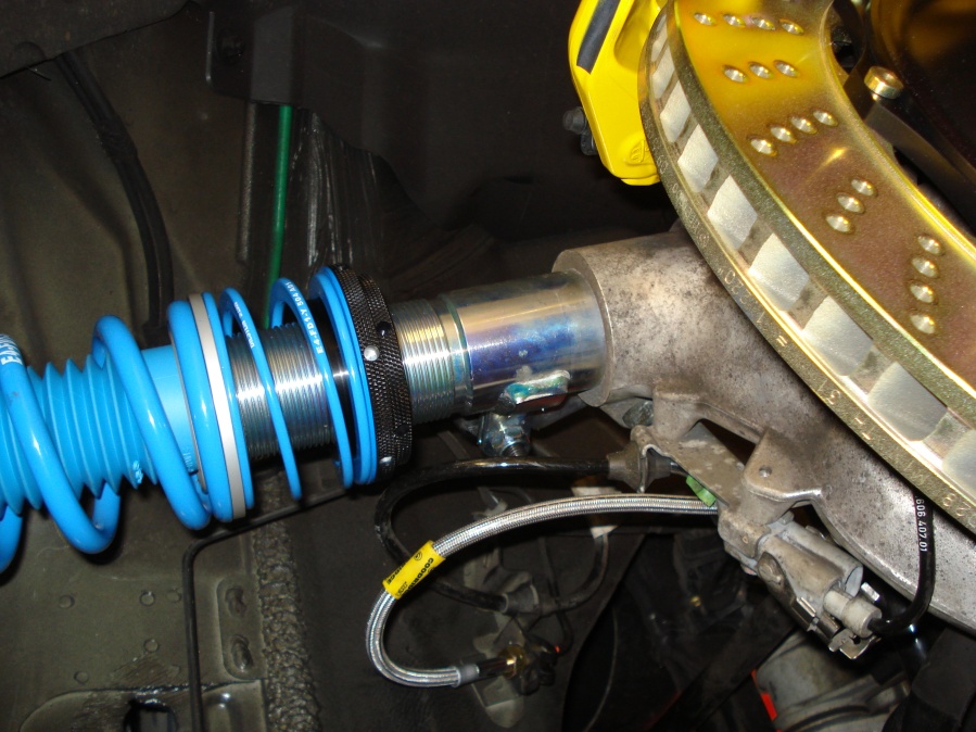

I wish there was a photo of how your setup looked completed . I have pictures of mine . I also have photo of the Bilstein sitting next to the Techart spring --which by the way is very nice spring .
I am not a technician or expert in any of this but as a novice it does not look as easy to install as one may imagine . That does not mean there is any excuse for yours breaking though.
