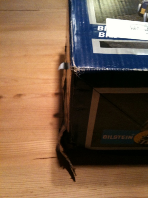

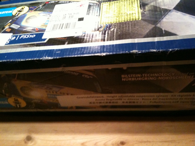

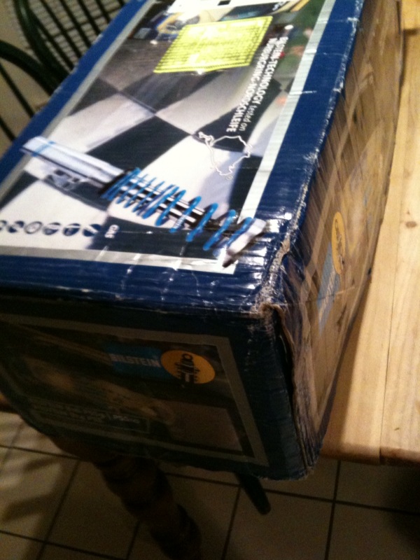

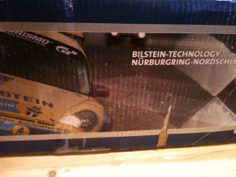

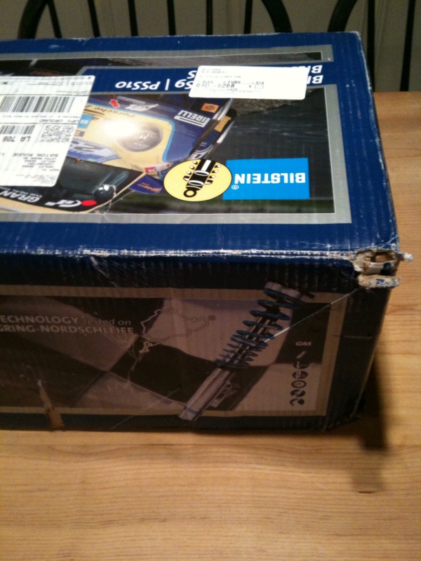

Originally Posted by drkbrent
Man, my box looked TEN TIMES worse than that! I was so concerned at how rough the box looked that I almost called the vendor, but changed my mind after I opened the box. Maybe I should have, who knows?
Maybe it's nothing but that would bother me. Where's the original box? I guess there's no chance of them being rebuit shocks?

I also got mine from AWE, in a crappy looking box, but I really don't think it's a vendor issue at all. But I will admit, your post has me second guessing removing my gmg springs/stock struts, which were flawless. Like I said, one slight issue and the b16s are in the junk pile.

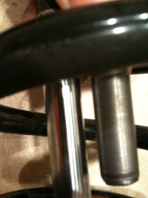

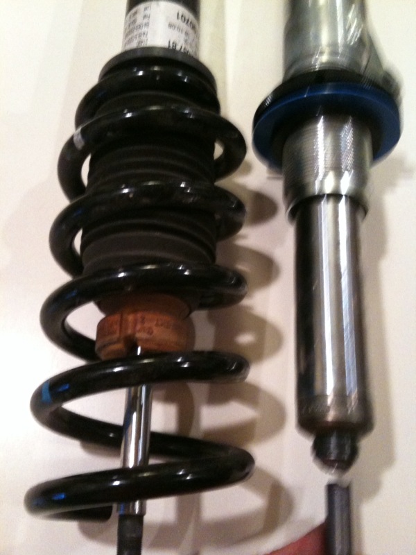

Photos - Stock vs. Aftermarket
OK, there is now no doubt in my mind whatsoever that the steel used in the manufacture of the stock shocks is of higher quality than the steel used in the aftermarket PSS10 Damptronics! It is as plain as day! The shock on the left is stock, right is aftermarket (both manufactured by Bilstein FYI). Notice the bright, shiny surface of the stock shaft vs. the duller, grayer surface of the aftermarket shaft. I don't know what this means strength wise (maybe forged vs. cast??)...but my gut tells me stock is stronger! I simply know that it is different material. I'd LOVE for a Bilstein rep to chime in here and tell me otherwise! No reasonable person can tell me this is exactly the same steel! I am SO tempted to buy another PSS10 myself, take it and my stock shock to my buddies machine shop, and run various stress and strength tests to the steel shafts!!! How many of you guys would find that interesting? Seriously, respond to this post if that would be of interest to you. For the first time, I'm actually starting to get pissed! Also, I have posted pictures of the box the PSS10's came in...pretty rough! Please note the box doesn't particularly bother me, it's what's IN the box that is important to me (some of you simply posted questions about the shape of the box, so I wanted to show you). Also note that AWE (my vendor) has been nothing but professional in this matter (they didn't manufacture the product, Bilstein did). I will be shipping the bum shock to them tomorrow.

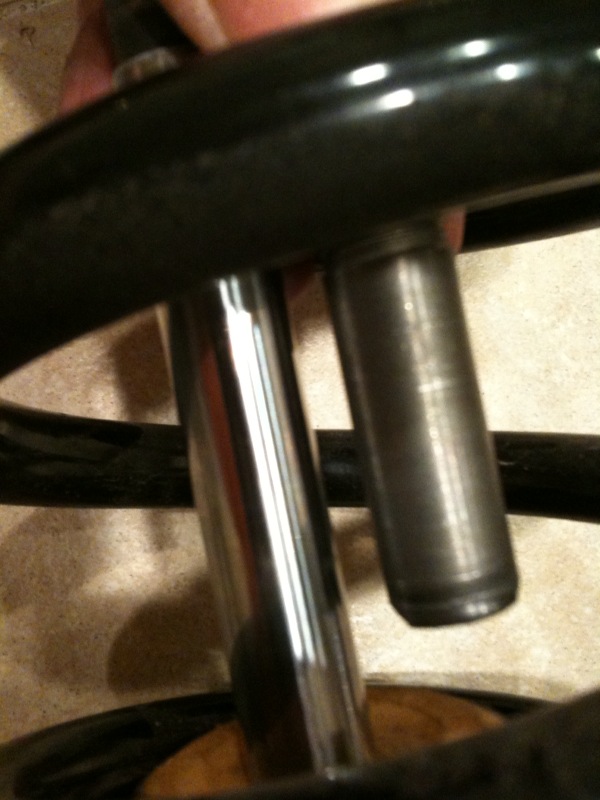

Photos - Stock vs. Aftermarket (more pics)
More pics.

Oh, also, has anyone here PERSONALLY experienced a stock shock breaking like this???
While I'm sympathetic to your situation, I'm not sure that the wear and tear on the outside of the steel shaft is a good indicator of strength. Here's my stock damper after swapping to Damptronics.
It's an area that get's beat up and exposed...even after light use, it's going look beaten.
bbywu, please pardon my ignorance (I'm not NEAR as a Porschefile as many of our members here) I don't understand what you're trying to tell me. My point is that the steel is simply different on stock vs. aftermarket...my stock shocks in the pic have 3,500 miles on them, and my aftermarkets have less than 100...again, my point is the steel is simply DIFFERENT and I ASSUME one is stronger than the other...I could be wrong...just a guess on my part based upon what the shafts look like...How many miles do you have on your shocks above? They look ROUGH!<!-- google_ad_section_end -->
