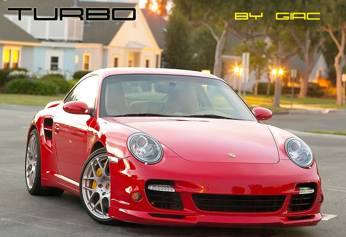

Pics & Review of My Bilstein PSS10 Lowered Red Turbo

Beautiful stance on the OP's set up i'm thinking just a plain lowering springs set up when my build is finished either Bilstein or H&R. I'll be basically street driving and occasional road course and drag scene.
