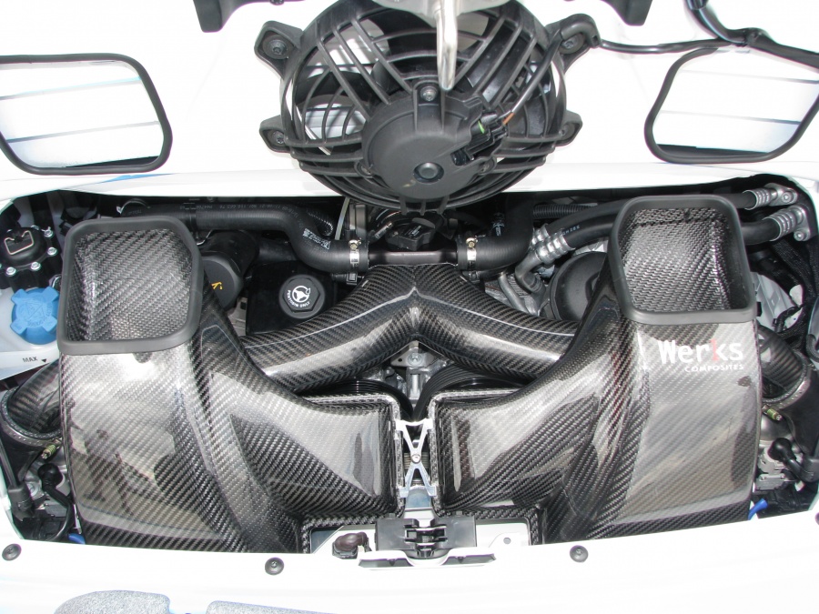

- CMS Billet Compressor turbochargers with 68mm 7 blade wheels
- CMS (new for 2010) intercooler upgrade, including silicon hoses and hardware
- Werks1 carbon Y-pipe for 2010 cars
- CMS compressor inlet adapters (increased flow)
- Werks1 carbon air box for 2010 cars
- CMS exhaust manifolds, 3 into 1 equal length headers
- Tubi Style Race exhaust system
- GIAC high performance software proprietary to CMS

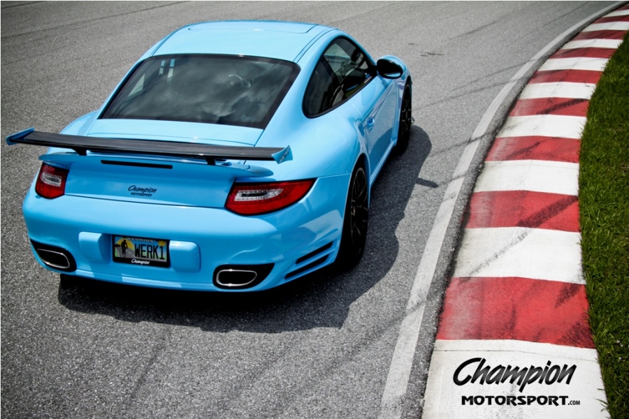

Aero and Body and Misc.
- CMS Forged Magnesium Center Loc Wheels 9X19 front, 12X19 Rear
- Michelin Pilot Cup tires
- CMS Werks1 Carbon Fiber rear wing and endplates
- CMS Werks1 997.2 Turbo rear diffuser
- CMS Werks1 Front Splitter
- Ice Blue Full body Vinyl Wrap
- Trim and mirrors in satin black
- Clear marker lenses

We have fully tested the PDK under all circumstances, at various power levels. At the power levels we listed, the PDK did not experience a single glitch. We left a margin of over 20WHP and 35Ftlbs torque.
As I wrote in another posting, Our Step 2 600WHP did slip the PDK clutches, so that kit will only be released for Manual transmission cars until we suitably sort a clutch upgrade for the PDK.. which will happen soon. The other interesting note here is that the 600WHP PDK kit will be software only, the development on the kit is already complete and tested.
Yes, the numbers are quite good, and even we were surprised. Realize that these tests were done independantly. We added 3/4 tank of pump fuel to the car, and handed off the keys for testing. All of this after running lap after lap on the race track all day long by several different drivers. The package is solid !!
Trending Topics
Thank you for the comment on the wheels. Our engineer Chris did all of the work on this one, and I think it may be his most amazing work to date. The MM20 will be available in Forged aluminum very soon.
Another interesting thing about the day of testing... The "boss" and I had a bet on the performance numbers that it would put up...... I won, and as a result I got to drive her home from the track and enjoy driving her for the evening.. It is quite a thrill knowing you are driving a 2.6 second 0-60 car that I actually dropped my kids off for school in the morning with.. (I did have to drop them off 1 at a time though)
