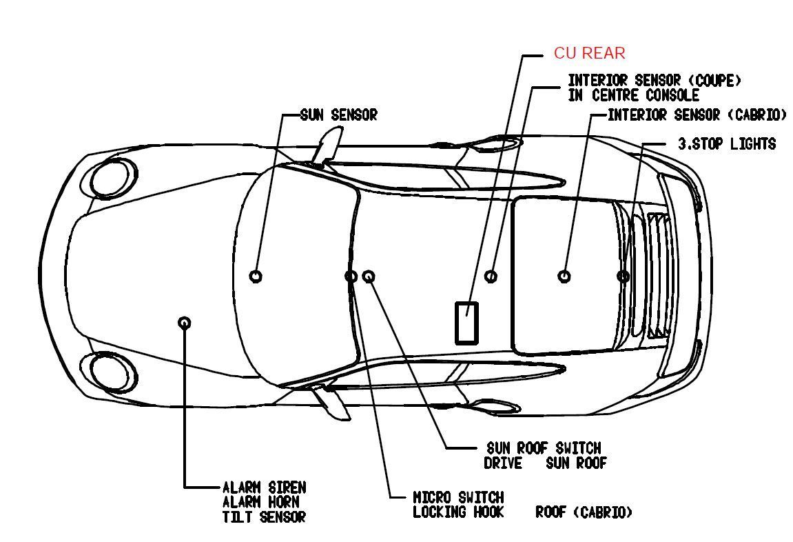

Is the rear control module in the passenger side suspension area? Is it possible the module went bad or there is some coding issue?

Probably it is indeed the CU REAR
Regards Hans

Just to update this in case anyone else comes looking for a solution. I replaced the rear module under the front driver seat and rear lights seem to be working again.
