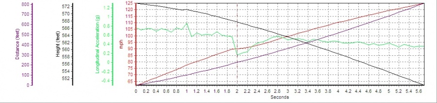

Here is madsex's 5.59 100-200 km/h. This run ended up being a 7.09 60-130.
Many thanks for that Scott...

Wow--you nailed it! Outstanding time for just a flash and exhaust. Next time when you get a chance, maybe you can run it just in 4th, 0 shifts. It would be interesting to compare.
Congratulations for awesome ran!!
Lately i noticed that there some cars ( including ur current ran ) ran more than 0.8-1sec when we compare 100-200 to 60-130.
In ur ran the differance is almost 1.5sec
Quickest 6speed modded vtg's ran 100-200 5.7sec ( which is slower than ur car ) and the 60-130 6.6sec ( which is quicker than ur car ).
Couple of Q for u
1- There plenty of happy and unhappy 997tt's with same ur tune and they never get like ur results...What do u think??
2- In ur sig
Matte Grey 997tt 09, APR tune/Europipe EP2 100-200kmh:5.59sec..60-130 7.09
Jet black 997tt 08, Salias tune/Switzer exhaust 60-130mph: 7.18sec
The 2nd car has local tune or what???
Old Oct 10, 2010 | 02:03 PM

He ran out of gearing, had to shift into 5th to get 130. He's on trajectory for 6.5-6.6 if rev limiter was increased.

Kostas Jet black car had a raised rev limit,so he reached 130 with 4th gear instead of 5th on the current car...APR tune needs 2 changes to reach 130mph,starting from 3rd gear...

Madsex,
You could try slightly larger tires next time you change them. This might get you above 130 at the top of fourth without moving the limiter.
So that's why they ran almost same??? and the Salias tune extend the rev limiter to 7000???
Top tuners in U.S extend the rev limiter to 7000-7200 for a years now and we never saw a car ran that fast ( like Kostas Jet black car w/Salias tune )
Is that mean that Salias tune better than SPI/Proto and EVOMS if im not mistaken... ( No disrespect for Salias tune of course ) ??
Again we NEVER EVER saw a car even a APR tune or any other top tuner in U.S ran like ur car or madsex..There is unhappy members with APR tune.
I still think that ur pumpgas is the main reason

I havent seen any APR client not happy so far...At least they dont write here...Well,our pump gas is not the best and the main reason for our performance is the tune itself...At the end this has to be understood here...When there was only my car flashed some fellow members were a bit skeptical about it...But we have two cars now...So its not a coinsidence...
P.S. about Salias,he is a well known tuner (ECU) here...Together we ve built many P cars inclding my previous 996TT that run 6,32 verified 60-130 with 18g turbos...some years ago...
