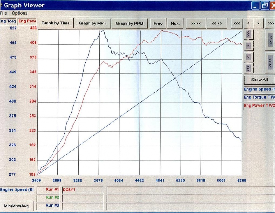

Old Aug 31, 2012 | 09:36 AM
bartg's Avatar
Joined: Aug 2012
Posts: 2
bartg is infamous around these parts
marketing vs engineering
claimed horsepower has been an issue for every car owner ever since there was a combustion engine.
I have a 996tt and recently had it dyno'd and was suprised to learn that even all dynos are not made the same.
But i learned alot about how my turbochargers work by looking at the power curves.
Old Aug 31, 2012 | 11:10 AM
JETmn's Avatar
Joined: Aug 2012
Posts: 71
From: Minneapolis
JETmn is infamous around these partsJETmn is infamous around these parts
That is weird that they have the TQ and HP on different scales, it really throws off the look of the chart compared to normal dyno charts. Your HP looks artificially high in the graph because of how they scaled it.
Old Aug 31, 2012 | 11:23 AM
bartg's Avatar
Joined: Aug 2012
Posts: 2
agreed
I agree. The scale is weird.
but I was surprised how quickly the torque drops off.
I was also suprised to see the HP didnt drop off with the torque.
And this is a 996 not a 997 so it has k16's not k-24's
