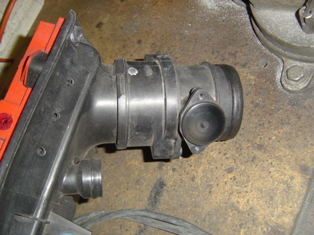

i also run maf less
Old Jan 24, 2011 | 07:48 AM
venkatreddytx's Avatar
Joined: Feb 2010
Posts: 525
From: Texas
Rep Power: 62
venkatreddytx has a reputation beyond reputevenkatreddytx has a reputation beyond reputevenkatreddytx has a reputation beyond reputevenkatreddytx has a reputation beyond reputevenkatreddytx has a reputation beyond reputevenkatreddytx has a reputation beyond reputevenkatreddytx has a reputation beyond reputevenkatreddytx has a reputation beyond reputevenkatreddytx has a reputation beyond reputevenkatreddytx has a reputation beyond reputevenkatreddytx has a reputation beyond repute
SMR
That's neat, did you fabricate the plug?
