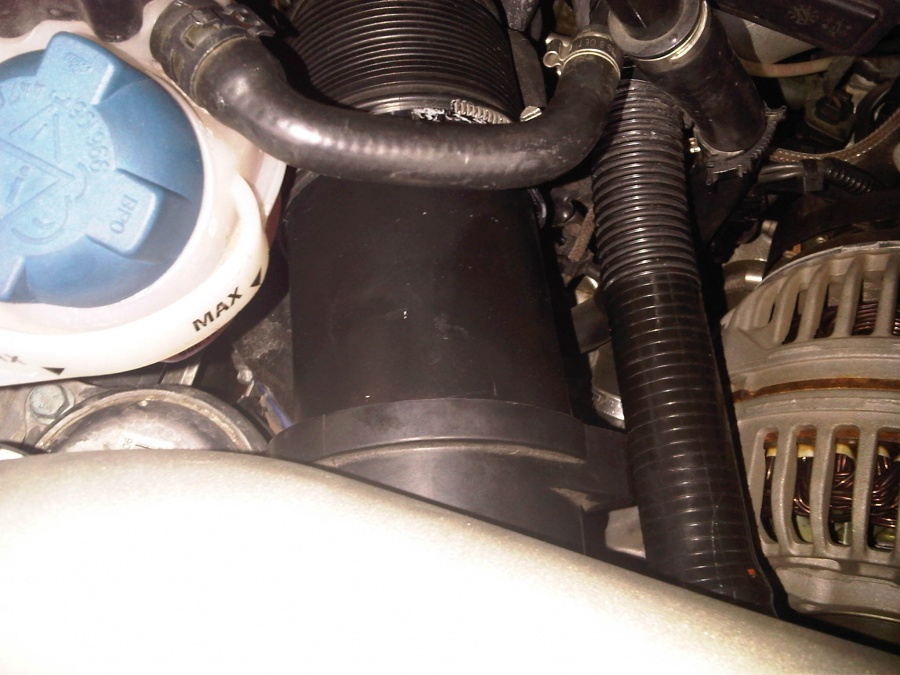

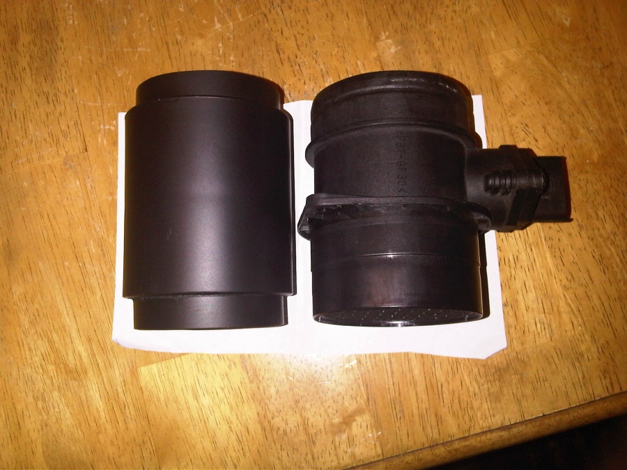

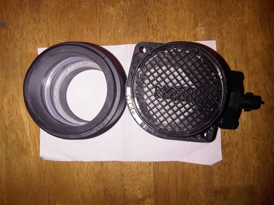

I decided to take out my MAF's completely since I run a MAFless tune and help
with the airflow on stock airbox and stock turbo inlet piping.
The throttle response seems better and butt dyno tells me car pulls harder.
Taking out any restriction in the airflow should only help car breath better.
I had 2 plastic pipes fabricated by a local fabricator, pictures attached.
