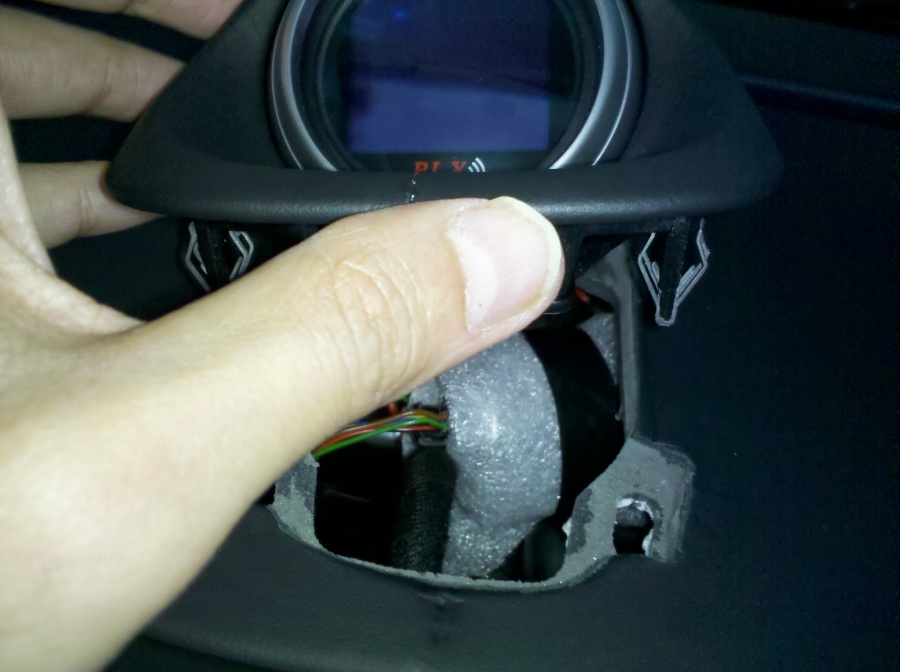

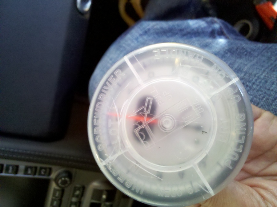

here are some preliminary pics, i was testing it before a final install, the cable is eays to run, from the dash there is big gap from the bottom, i covered up the clock face with a paint can cap , cut in half to protect the clock face and hands, and i tucked in the dash hole and pushed back the wart with the new gauge, the reason i did so my sport chrono is fully functional because if you unplug the clock the sc dos not work. i made some custom back ground for th gauges, will put video soon and a DYI

Looking good. Is the swivel function built into the housing or the chrono itself?
Looks good. But still a bit confused as to how you wired it to your OBD port/fuse box for power? And if I understand correctly, you just tucked the sport chrono clock into the hole in the dash and put the wart right on top of it?
