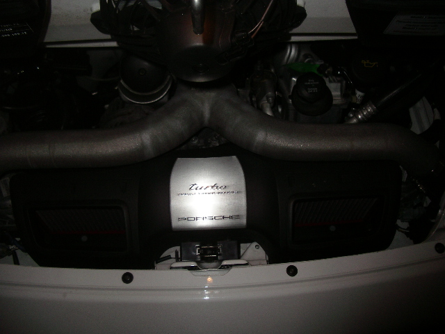

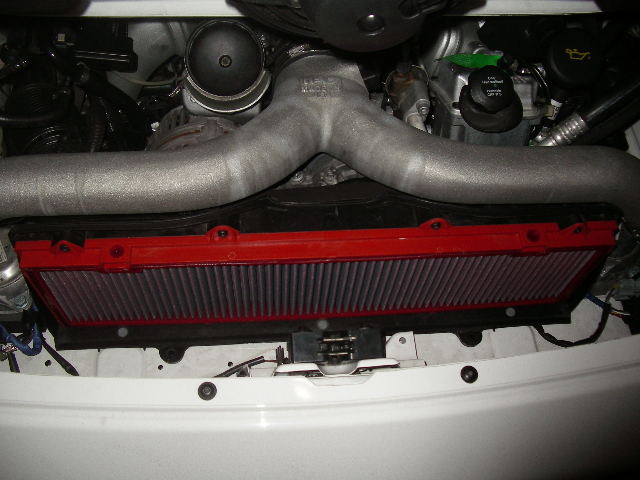

It's very easy to do
Open your engine lid.
1. Pull the air cover straight up (1 hand on each of the openings and just pull up gently).
2. It will reveal the air filter. Air filter is held in with 4 screws. Unscrew and pull air filter out.
3. Replace air filter. Re-install the 4 screws, and reinstall the air cover.
It's THAT easy. 5 minute job.
