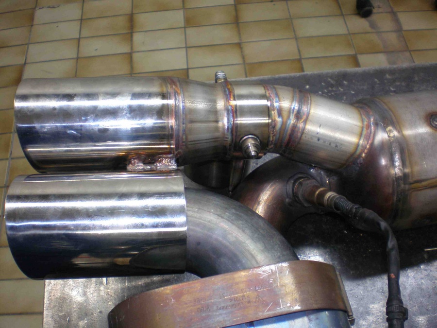

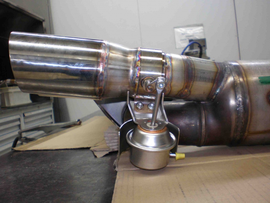

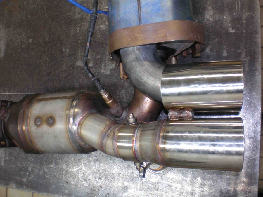

well i have one based on the GT2 akrapovic box, it is controlled by a separate ecu and i love it. Sportec made this for me and it has the best of both worlds. The power gain is around 30hp and torque difference is noticeable. Had some teething problems with some loose screw in one of the throttles but now works like a dream.
It is also very healthy for the VTGs not to mention the silencer box (I am running 700+ hp). It costs a lot but I absolutely love it. The trick is to have an off/ auto button that operates it when needed (ie after say 0.8 bar and beyond 3k rpm). It is a MISTAKE to have the flaps on below those 2 parametres as you lose response (and the drone sounds awful). The akrapovic box makes a fantastic sound compared to any other AM exhaust i have heard..

one more thing to add, we measured backpressure with flaps open and closed. With closed flaps and 100 cell cats the backpressure was around 200-250mb at 1.55bar boost (best AM exhausts are more like 300-350mb). With flaps open the backpressure was virtually 0 (<50mbar). That means that you can truly get 20+ hp more with a flaps system that any other AM exhaust will claim.

GT-TT: Yes, I've seen your posts before... I think what you've done is really clever... did you take photos during the build??? Do you have a exact list of parts including the valve you used and the controlled etc (links?)....
How much did the whole thing cost you??? I have considered adding a valve to the EP1.... PLEASE DON'T SHOOT ME!
