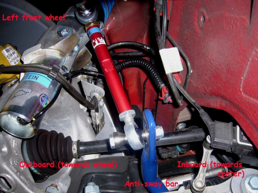

Pretty normal if your car is lower more then 25.3/4 in. measured from the ground to the fender in front.Make sure you install the extended Tarett links that are connected same way as Bikstein drop links.Attached Canaga pic..
Thanks, I received the wrong size yesterday but Tarett is going out of their way to overnight the correct set for delivery tomorrow morning. Hopefully, we'll get them installed and I can still get to the track for the weekend's DE. Thanks for the picture too. It's good to see one actually hooked up. Best,

Also make sure that after installation thy check links for full side to side travel clearance
