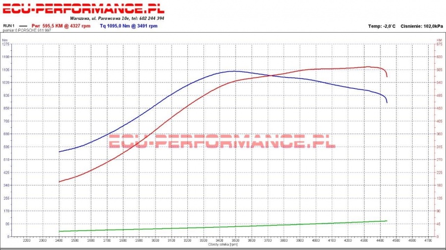

Old Jul 31, 2011 | 05:09 AM
997 GT3 RS/TT's Avatar
Joined: Jun 2008
Posts: 1,041
From: Warsaw
Rep Power: 93
997 GT3 RS/TT has a reputation beyond repute997 GT3 RS/TT has a reputation beyond repute997 GT3 RS/TT has a reputation beyond repute997 GT3 RS/TT has a reputation beyond repute997 GT3 RS/TT has a reputation beyond repute997 GT3 RS/TT has a reputation beyond repute997 GT3 RS/TT has a reputation beyond repute997 GT3 RS/TT has a reputation beyond repute997 GT3 RS/TT has a reputation beyond repute997 GT3 RS/TT has a reputation beyond repute997 GT3 RS/TT has a reputation beyond repute
I thought your car is at champion and you decide to go with vtg's?
in my opinion gt30 are much better than any vtg you can have.
this is dyno run on 6th gear and max load maha can go.
1,4 bar boost.
1,4 bar boost.
My Car is at Champion and given the fact I am virtually guarenteed 900 WHP++ and close to that in TQ (close to 50% of that starting at ~ 3500 RPM's) I am perfectly happy. I wonder why Porsche went with the VTG design when they could have gone elsewhere?
