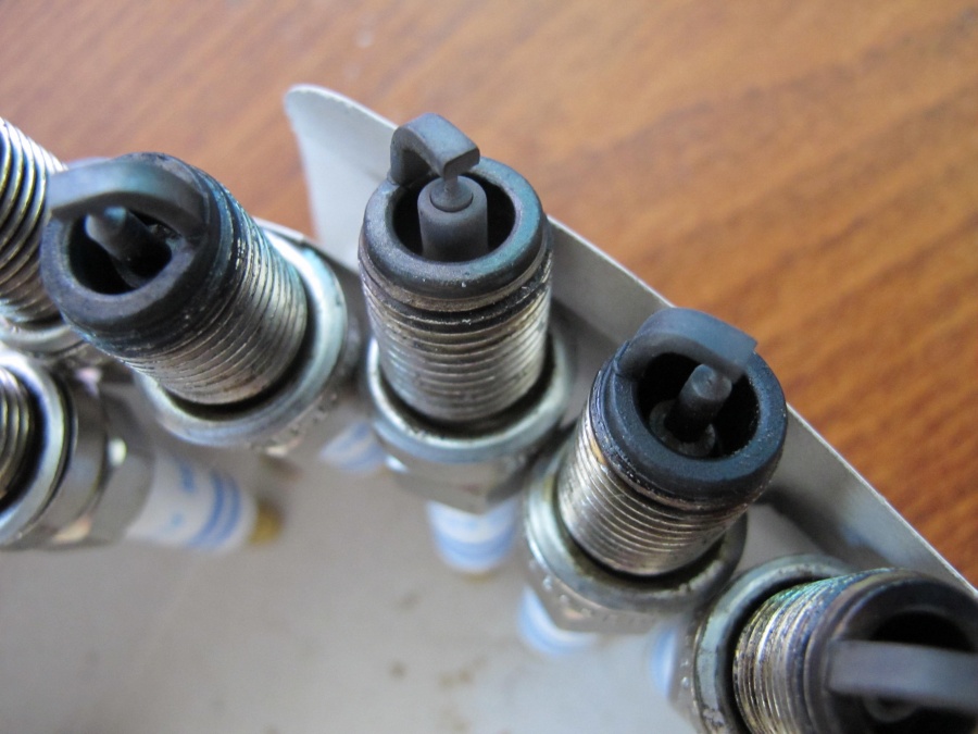

So after about 2 months (less than 1400 km) since I replaced my plugs and coils for OEM I started to get a heavy misfire again. Just went through the ordeal again of having them replaced ($1200). I went with OEM's again but had the Porsche dealership flash my car back to stock until I could have a word with all parties involved.
Either the Tune is eating up the plugs (but find that hard to believe as a lot of folks on this board are running the same tune), or I got a bad set of plugs, or there may have been issues with the installer (Independent shop).
Attached are pictures of the plugs, as you can see the interior insulation (around the shaft) has been completely disintegrated. Only one plug actually has the insulation left. This is probably due to thermal expansion and contraction (shock) or detonation, which causes it to crack and disintegrate.

wow that is a sign of serious heat damage/detonation. Unfortunately there are a number of things that you may find need attention:
1)the ceramic debris from the insulators went somewhere - possibly your combustion chambers and could scratch the cylinder walls. I would do an immediate oil change and send the oil for analysis. I would also consider doing a leakdown and compression test
2)your turbos are probably in need of a rebuild. VTG turbos are very sensitive to excessive EGT's and you may have damaged not only the bearing cartridge but the actual impellers
3)check your intercoolers for signs of aluminum debris/dust. That would be signs of the turbo impellers disintegrating. The intercoolers need a thorough cleaning with solvents and compressed air

It does all point toward the tune though unless you have a fuel pump/fuel delivery issue and its been leaning out under throttle. High combustion temps/detonation are the cause for the premature failure of the plugs. I agree with eclou you may well be looking at further damage within the engine as well. It's highly possible given the very short length of time it took to destroy the new plugs.
Btw how old is the exhaust? Whats the mileage? Did it have a tune prior to your ownership? Possibly your exhaust or cats are all choked up. Restrictions in exhaust flow will certainly cause abnormal combustion temps and an overfueling engine will eventually clog the cats ad muffler. The soot has to get caught on the way out. There really isn't a whole lot left here to look for that hasn't already been addressed in your recent maintenance. Be keen to hear the final wash up.

It all comes down to the turbos.
Apparently when the vanes got stuck they built up back pressure which threw the mixture off, which got exaggerated with the tune which demanded extra boost. And that is what ate the plugs up. Apparently the OEM plugs last 15,000 miles with this tune, tried and proven. One step colder plugs won't make much difference unless one is running a turbo upgrade package with the tune with around 700+ hp. Else you're not going to see much difference in life span.
Another contributing factor to this could have been a bad batch of fuel.
The car has 40k miles on it, exhaust has been on for some time, before my time (TechArt & 200 cell cats), and all work fine now. The car has never had a tune on it before I threw one on.
Regarding the plug disintegration, speaking with two different Porsche mechanics, both said that the insulation material around the center shaft is ceramic/porcelain, so it would not damage the combustion chambers, simply it would disintegrate into fine dust - not good, but not bad either.
