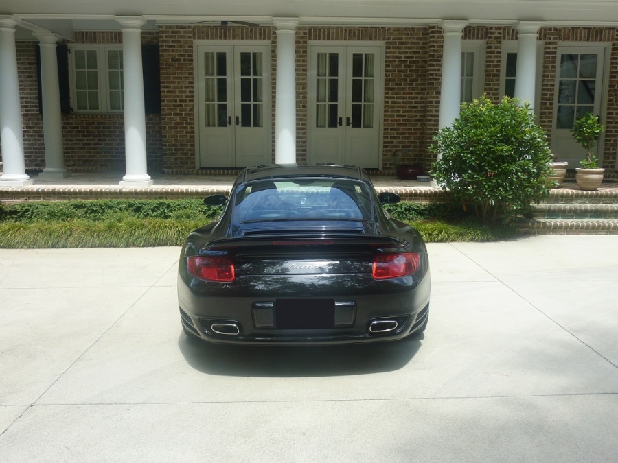

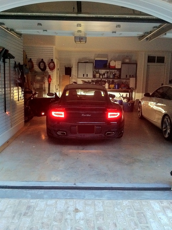

Old Aug 18, 2011 | 08:53 PM
hed's Avatar
hed
Joined: Jun 2011
Posts: 107
hed is a jewel in the roughhed is a jewel in the roughhed is a jewel in the rough
Pictures of the lights. I didn't think about pics until after the install. Please excuse the crappy shots, iphone camera and Panasonic handheld
