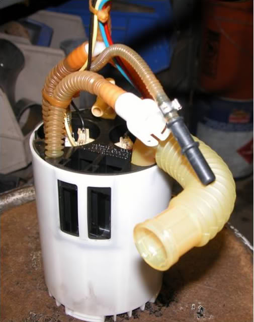

Originally Posted by venkatreddytx
997.1 has dual fuel pumps stock vs 996 with single fuel pump stock.
997.1 stock pumps can support fuel flow rates for 83lbs injectors vs 60lbs OEM.
where is the second 997 fuel pump located in the car? I do not find it within PET or part list PDFs from porsche or with google
are they in line or parallel?
thanks a lot.
Old Mar 18, 2013 | 08:25 PM
  #29
2swoosh's Avatar
Joined: Jun 2011
Posts: 759
From: cherry hill, nj
Rep Power: 60
2swoosh has a brilliant future2swoosh has a brilliant future2swoosh has a brilliant future2swoosh has a brilliant future2swoosh has a brilliant future2swoosh has a brilliant future2swoosh has a brilliant future2swoosh has a brilliant future2swoosh has a brilliant future2swoosh has a brilliant future2swoosh has a brilliant future
Check out my build that will commence very soon my platform will be a bone stock 03 996 tt with 43k miles and i will only use one shop/tuner. The mods will start with a bone stock baseline dyno then install a ProEfi ecu with flex fuel capability and do another dyno to see the max capacity of the factory injectors and fuel line system. The tuner will then install an upgraded rods and raceware studs together with a pair of Precision 55/58,turbo kit, and add the necessary matching injectors and fuel pumps,lines,etc.. with the goal to produce a minimum of 800 to the wheels and upward of 1000. Budget will be around +/- $40k complete and tuned. Is this realistic? or pie in the sky? the shop is in NJ and everyone is invited to see the build in person. I need some constructive feedback/questions from the experts here.
Old Mar 18, 2013 | 09:10 PM
  #30
TTdude's Avatar
Joined: Oct 2008
Posts: 2,321
From: Fastlane USA
Rep Power: 246
TTdude Is a GOD !TTdude Is a GOD !TTdude Is a GOD !TTdude Is a GOD !TTdude Is a GOD !TTdude Is a GOD !TTdude Is a GOD !TTdude Is a GOD !TTdude Is a GOD !TTdude Is a GOD !TTdude Is a GOD !
thanks a lot.
Both pumps in parallel in the sump.
