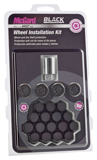

Also, will this Locking Wheels Bolt Kit & Bolts Package work on this wheels? (no spacers)
Thread Size: M14 x 1.5
Hex Size: 17mm
Seat: Radius R14
Shaft Length: 35.8mm
Overall Lenght: 59.2mm
