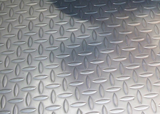

I installed Race Deck years ago in a garage for my 996 Carrera track car:
It looked great at first and installation was very easy, but there are a few issues with it.
1) Don't get white tiles! It never gets clean, oil and tires are black etc etc.
2) Water/liquids suck (rain, washed car, oil spill etc). The first issue is the diamond pattern, it makes it hard to clean anything up(paper towels just shred) and even makes it hard to sweep. The second issue are the seams between the tiles. What you don't wipe up disappears under there. So over time the concrete can get damaged and you won't even know it.
3) You can NEVER use jack stands without a board under them and same goes for the jack itself. With a lowered car this becomes a whole other issue of having to get the car up on ramps first just to be able to jack it up. I ruined several tiles by putting jack stands on them without a board under them. Then you've got to tear up half the floor just to get to the one tile to replace it.
If you live someplace like New England(rain, sand, salt, snow) and the car you have in there is daily driven AVOID at all costs! If it's a nice weather only car(like a track car) or you live in AZ or Cali then just consider the 3 items above. If you must have tile, then go with real tile(large 1x1 or 2x2 tiles) and the only issue you will have is dealing with the grout.

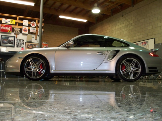

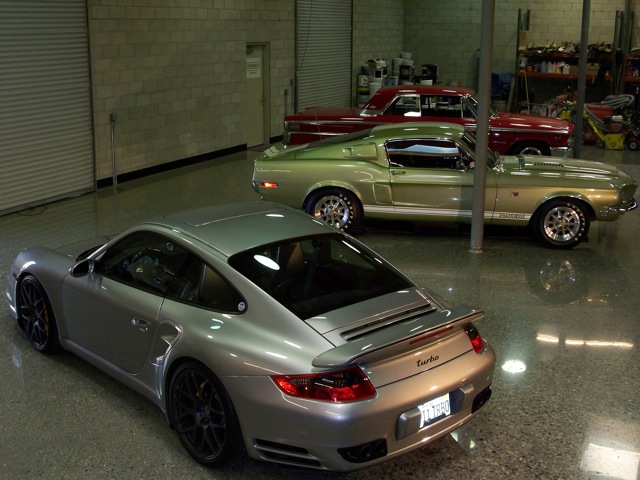

I actually do this for a living & the epoxies look good but will always start to chip & fail even when professionally installed especially in the hot spots under the tires. If you still want the diamond plate look of race deck you can use sheet vinyl without out any of the above mentioned problems thats what i used in my garage at home.For a bullet proof finish go with polished concrete this is what i did at my shop where i keep the muscle cars no sealers or wax to wear out. just polished with big grinders ,check out the reflection you get

Wow that polished concrete looks amazing!

Yeah it's def the way to go ,the process is done to your existing concrete ,the rocks you see is the aggregate in that's in all concrete just below the surface.The floor shown in my building i did 10 years ago & still looks perfect.
