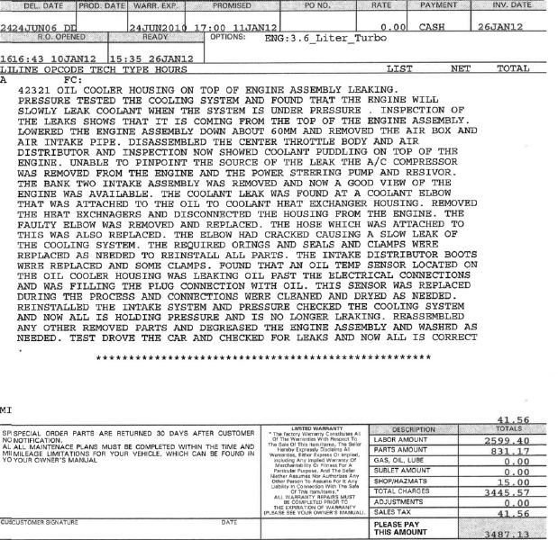

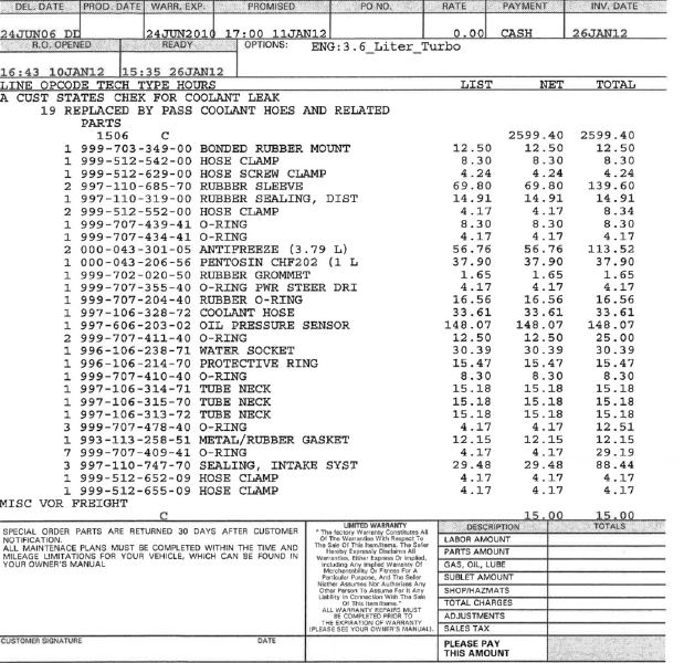

Originally Posted by ssj4
Here is the final answer.

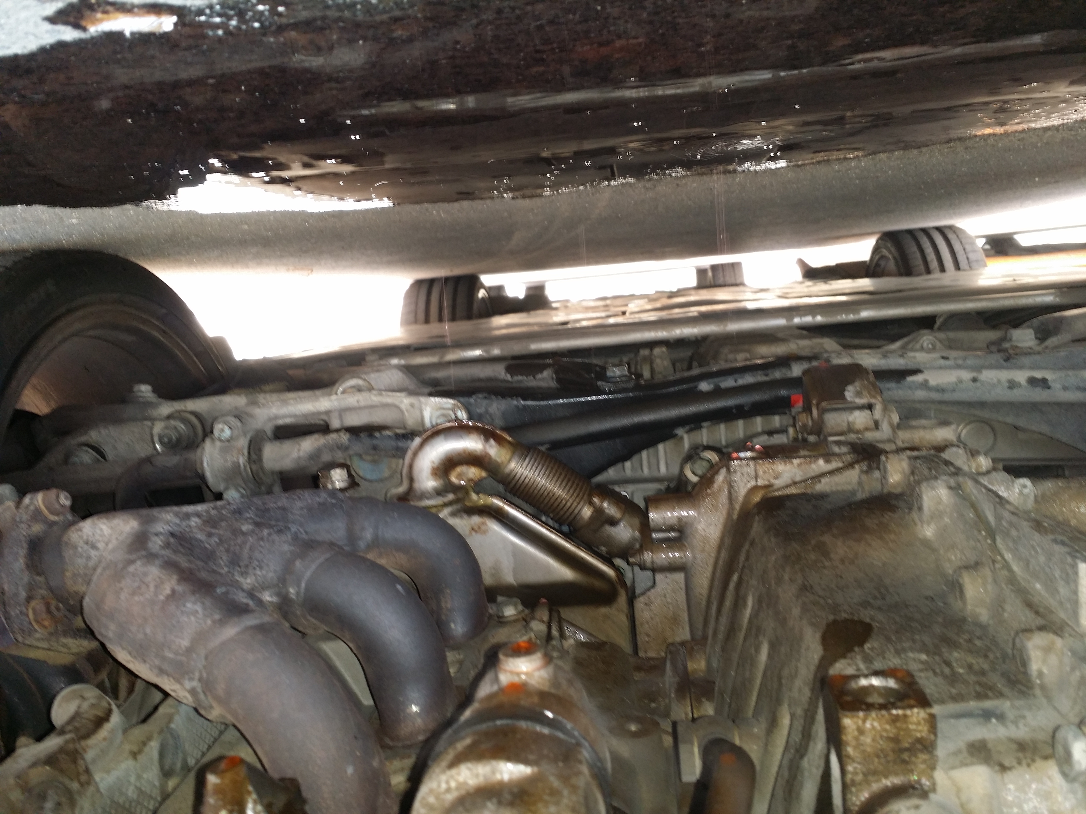

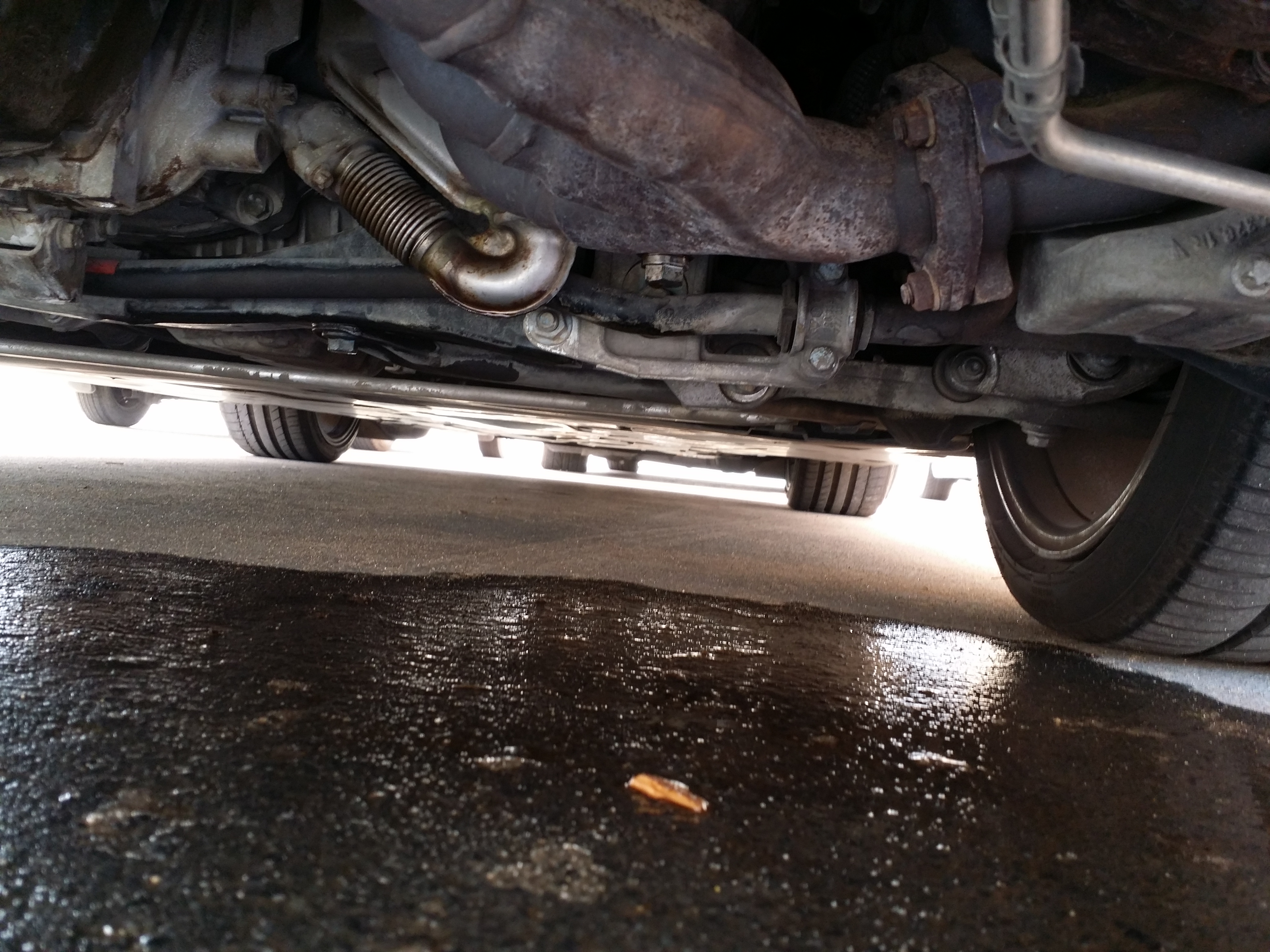

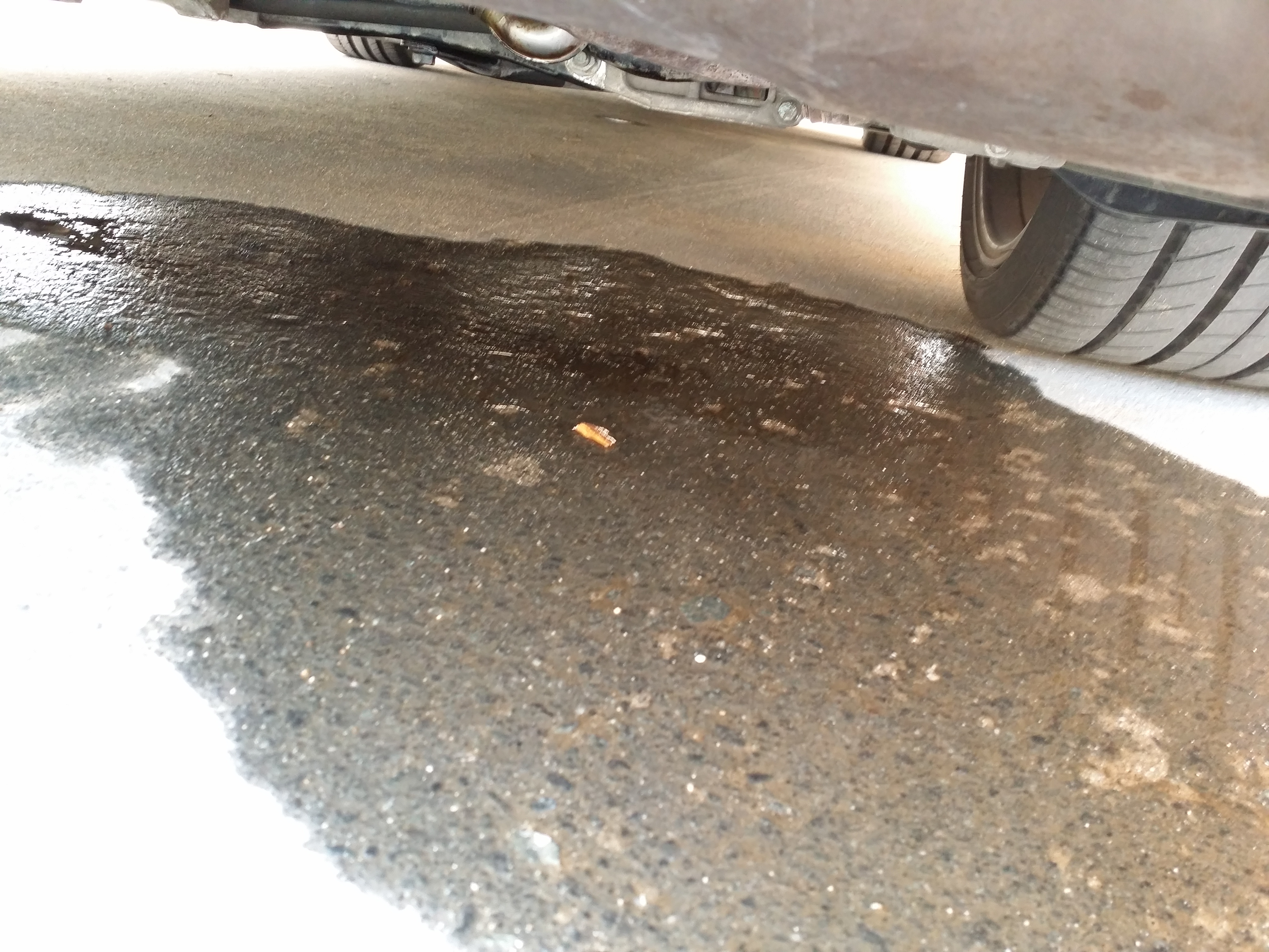

this is what I discovered few days back, major coolant leak!!

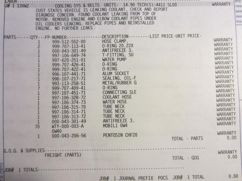

Yes. I was lucky that my CPO warranty took care of my coolant leak.

Your car looks more like water pump failure to me. Have you heard any noise from the back lately?

Oh... I still have one year of CPO on my 997tt left, so I hope it will be declared covered by warranty as in the SWC's case. Or else, we are at $2300 as of now and still counting.
By the way, here is a pretty good article covering coolant leaks,
http://sharkwerks.com/porsche/techni...urbo-cars.html
Any experience with replacing original plastic pipes with one's made of stainless steel?

I don't recall any noise from the back, the leak was from the right back side (passenger side), is that where the water pump is?
70 quarts of Mobil1 0w40 to repair a coolant leak...?

Not sure where the water pump is located but when my water pump failed, huge amount of coolant was leaked on the floor and I had a little noise before it happened.
They put 7 quarts of oil, not 70.lol It's a typo. They had to remove oil coolers in order to access coolant pipes.
