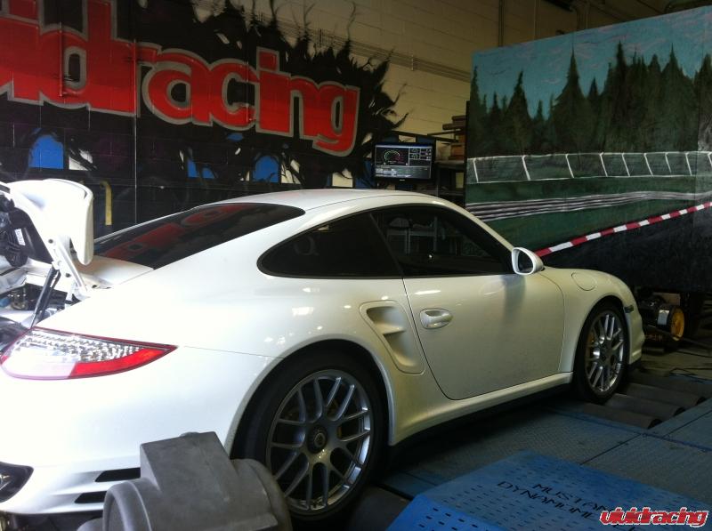

Coming from the factory with 530bhp in this Porsche Turbo S, it was already at a new level of quickness. We needed to see what the car could really do. Having tested on our dyno a 2010 Turbo PDK we were familiar with and where the baseline and ECU Flash tune would be approximately. Even though the Turbo S comes from the factory with 30 more horsepower, there is always more room to improve. Being on a Mustang AWD Dyno and having 91 octane as pump gas, the numbers were against us already. Typically the Mustang dyno has a 20-25% drivetrain loss. When running the Turbo in Sport Mode, the vehicles throttle response and low end torque is noticed on both the dyno and street, however based on EGT temps, Sport Mode can usually yield lower mid to top end power.
As a completely stock car, we did tests in both Standard and Sport Mode to show the difference in power gains. What we yielded was a peak of 541awhp and 534ft/lbs of torque with the flash in Standard Mode. This car actually exceed the typically drivetrain loss showing that the Flashed Turbo S was actually much stronger then expected. With Sport Mode on and an increase in boost pressure, the car spooled up quicker making peak torque at about 400rpm faster. However this then tapered off earlier as usual with cars in Sport Mode. Sport gave us a peak of 532awhp and 524ft/lbs of torque.
The best part of the ECU Flash, it was all done in about 20 minutes using a laptop and plugged into the OBDII port. No removing the ECU, dealing with scratching the interior, or having to wait for the power. Check out the pictures and video below.

- Standard Mode – 541/534
- Sport Mode – 532/524
