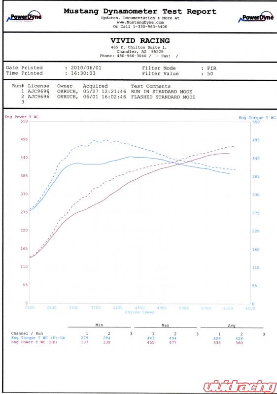

Here are dynos from when we did the 2010 Turbo and my 2011 Turbo S. These will not show boost numbers, but you can see the notes the run of Sport and Standard. Maybe your Sportec flash is different. Either way...
ID:	327938   Click image for larger version

Ok, thanks, that's a little helpful. So I take it you do not have boost recorded in any of your runs?
Where did you get the boost numbers you stated previously?
I'm really interested in the boost aspect of the tune.
Walt
Old Oct 23, 2012 | 02:40 PM
  #83
vividracing's Avatar
Posts: 17,404
From: Gilbert, AZ
On those dynos boost was not recorded. The boost numbers are from owning and driving the cars as well as flashing many cars and dyno tests.
