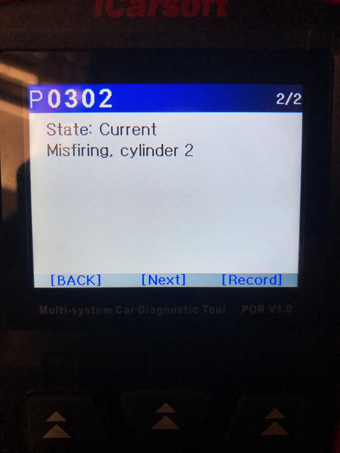

Originally Posted by darkhorse1
That is strange. Did they test the injectors when they were out of the car...? what are fuel trims, can you do some logging? Do you have durametric? If you dont have Durmatric you should get it, live logging is what you need and pull the fault codes from the car.
I got this fault code before the repairs and have not got it since but only had 2 big missfiers since as worried to drive it in a way that would bring them on. Will buy fhe Durametric

Old Jan 11, 2020 | 07:05 AM
  #36
darkhorse1's Avatar
Joined: Mar 2019
Posts: 75
From: Rolling Hills
darkhorse1 is infamous around these parts
Yes, that looks like a generic scan tool? You need either PIWIS (not likely unless its a good Porsche Indy or OPC) or Durametric which is more than good enough for 99.9% of anything we need. You need to be getting the actual P codes that looks like a generic code which is not reliable to base investigations off from my experience. I used to get some weird codes using a Snap on scanner, then Durametric just told me everything precisely, and some things the snapon said were complete bullsh*t
I have the non pro version, the main difference with pro is you cant code things with it. But it doesnt have the coding power of PIWIS anyway so if I need anything coded I will use an indy who has PIWIS or get a clone piwis setup
