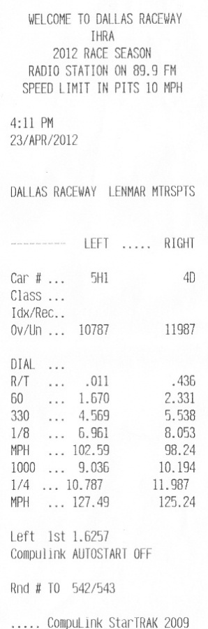

Took it back to the track today and ran a 10.787 @ 127.49. Just needed some more runs with it to get it down pat. Started at 11.119 today and worked my way down.
